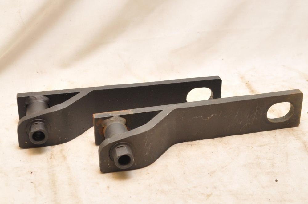

      Jack B said:
      The Dodge engine brackets come from the dealer.
      Are you referring to these ?
      No – Call woodhouse, they did stock them. Look at the engine (left front corner), there is a open bolt hole, one goes there. The other is in the right rear corner.

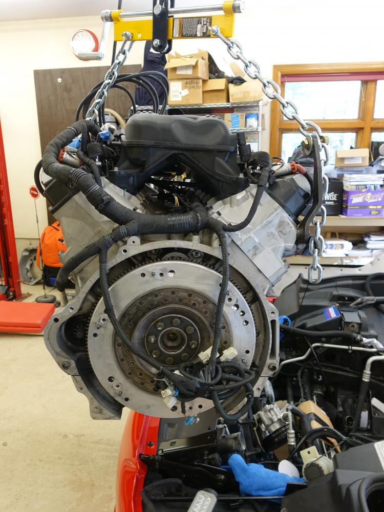

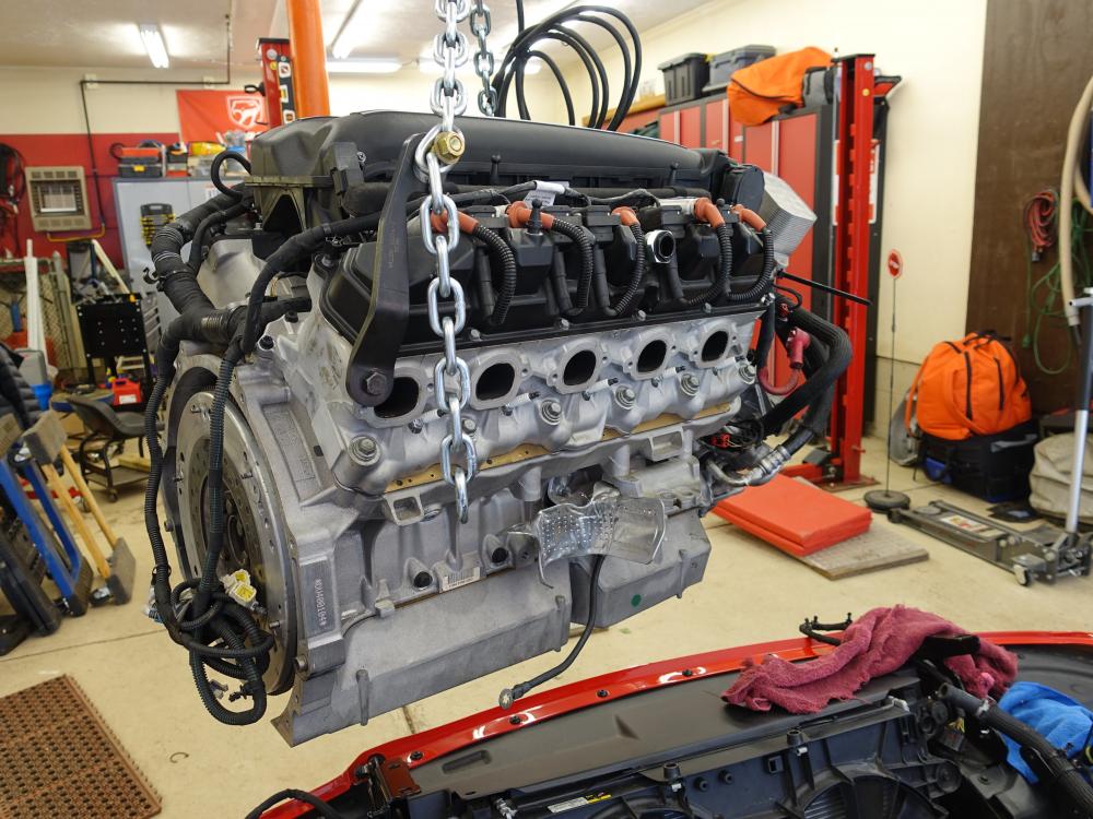

      Found some Pics:
      Here are a couple profiles of the SRT bracket and a lifting sling:
      The before pic is below

      Bump. I’m pulling my engine in a couple weeks. Does anyone know the part number for these brackets? I think I have seen these exact ones from mopar with a part number online but can’t track them down again.
      Jack B said:
      Found some Pics:
      Call mark at Woodhouse
