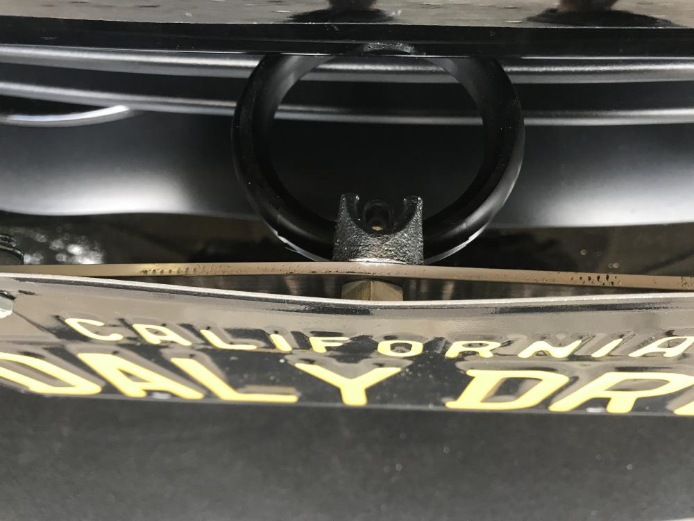

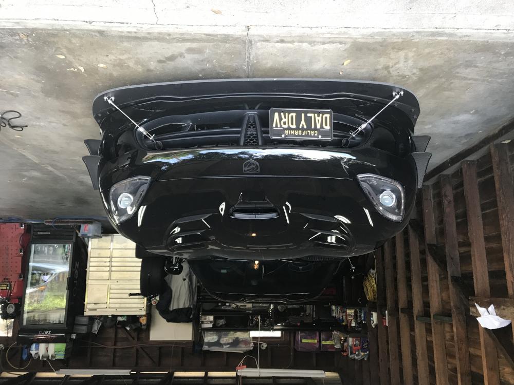

      Ok kids here’s my solution-
      IPSCO Front tow hook
      1-3/8 cable clamp
      1-1/8×1 1/2 aluminum flat bar
      Cable clamp clamps to front tow hook. Flat bar bolts to front of cable clamp. License plate Mounts to flat bar. I did have to grind the inside of the cable clamp to fit around the tow hook, also raptor hook and black electrical tape. Cost less than five bucks as long as you’re do you have the tow hook. Ticket signed off, back on the shelf for my until my next one.IMG_2940.jpg

      IMG_2938.jpgOk kids here’s my solution-
      1-3/8 cable clamp
      Cable clamp clamps to front tow hook. Flat bar bolts to front of cable clamp. License plate Mounts to flat bar. I did have to grind the inside of the cable clamp to fit around the tow hook, also wrapped hook with black electrical tape. Cost less than five bucks as long as you’re do you have the tow hook. Ticket signed off, back on the shelf for my until my next one.IMG_2940-1.jpg
