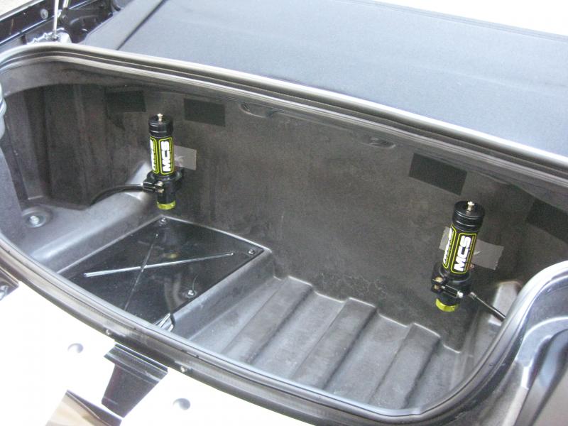

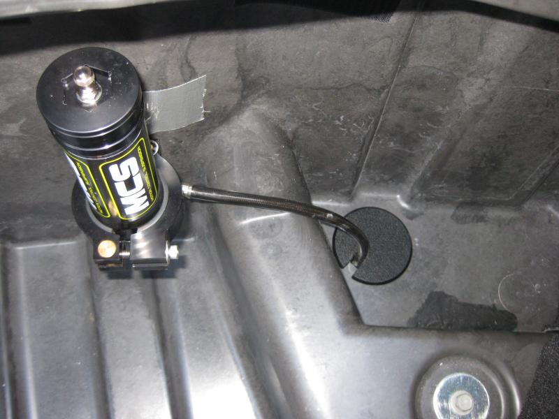

      I drilled mine as have others in the little cubbies on each side of the trunk. Slipped the cannisters through and mounted on back of trunk. The hoses tuck neatly beneath the carpet when transitioning from the cubbie area into trunk. I’ll see if I can find some pics.

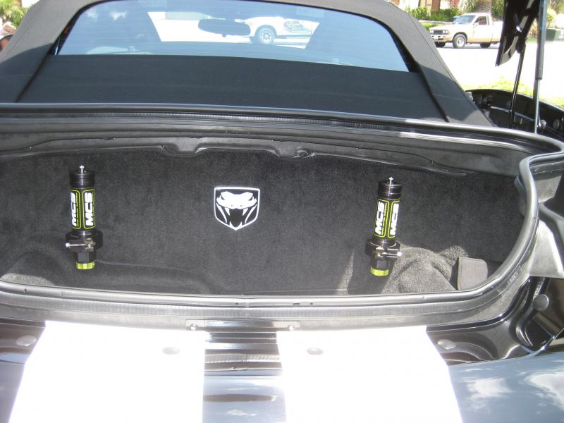

      Here is where I mounted mine in my Street Serpent:
      PS – The Fuel Tank is right in front of the trunk – so be careful how/where you drill.

      Here is a pic of mine. I have pics of the install but will have to search for them.
      Here you go.
      Excellent thanks for all the help.
      Exactly what i did down to the brackets. :p
