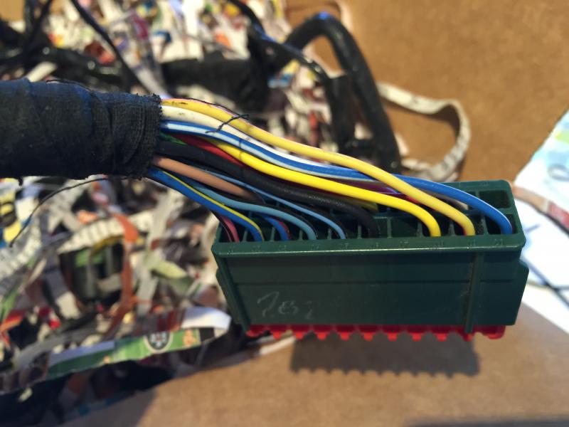

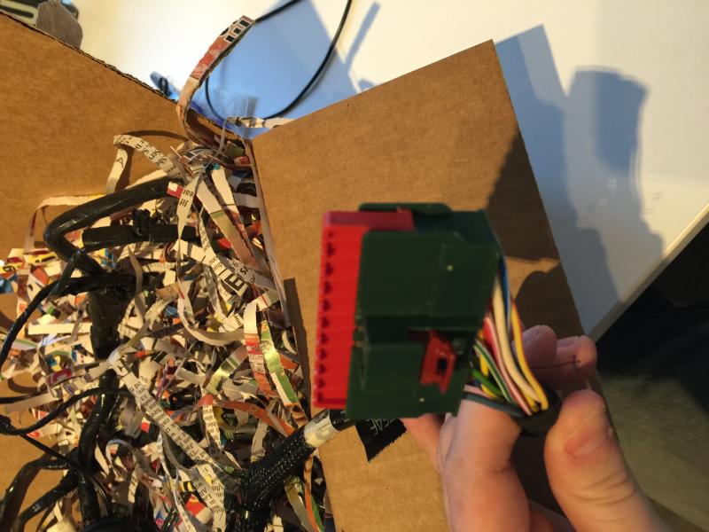

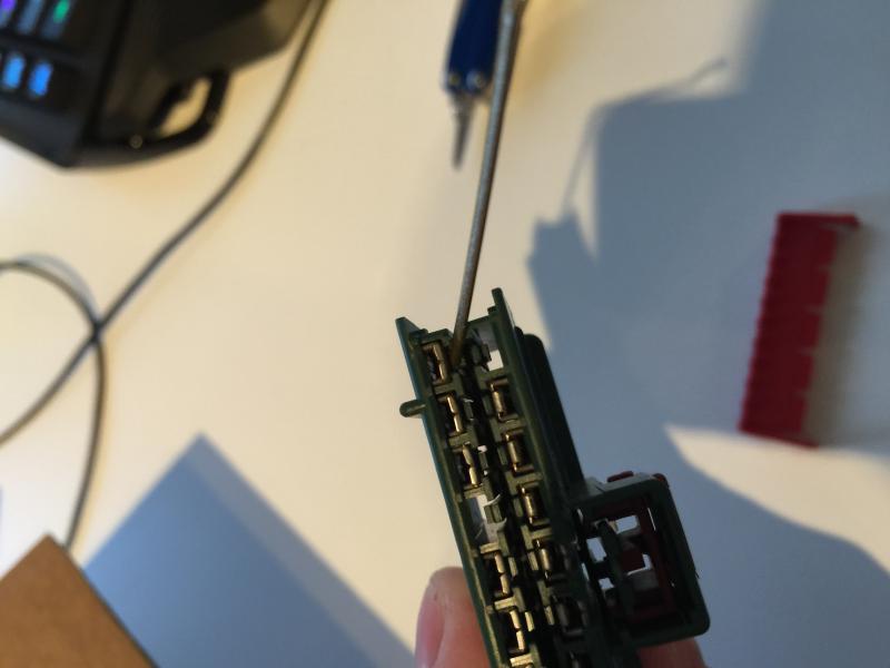

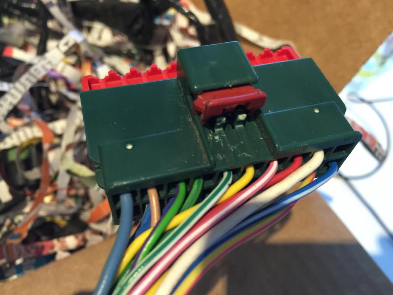

      The plug itself is very easy to disassemble – for the 20 pin version I had (donor), there was a red center piece that came out after prying the sides up a bit. In the pic below, it’s halfway out.
      On the 18 pin version from my car, there was a white slide that came off the performed basically the same function. Again – halfway out:

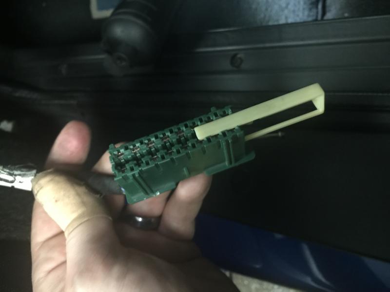

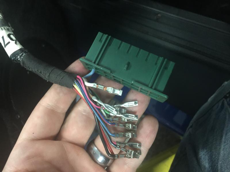

      Once you’ve exposed the plugs by removing the center guard piece, I found a bobby pin with the end clipped off to be the most helpful tool. Each plug has a little tab toward the center which needs to be pried back a bit and the individual receiver can be pulled out.
      Here all but one wire have been removed –

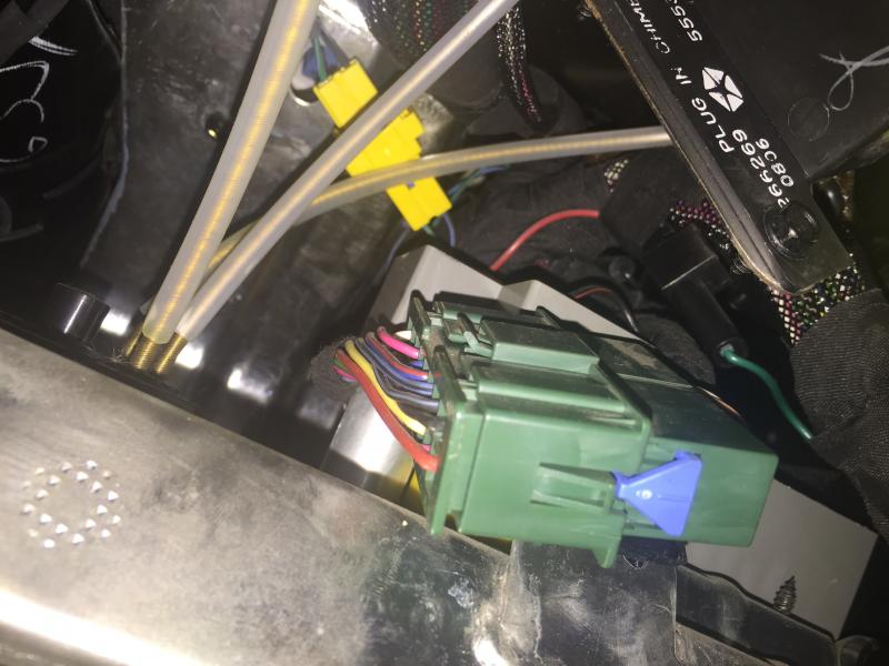

      Pulling the wire outside the car isn’t terribly difficult, but it is a fairly tight area to work in. For starters, you’re going to have to get your head in the drivers footwell. You’ll be able to see the green plug toward the center front area under the dash. There is a clip to hold the plug in place, though mine had broken itself off that clip. You can see the 3 cables from pedal adjustment behind the plug as location reference.
      Unfortunately I don’t have pictures for how to unplug the green plug but again it was different from the 20 pin version (my donor) to the 18 pin version on my car. On the 20 pin with the red, it looks like you pull rearward on a red tab at the clip to unlock it and then it can be unplugged (look at some of the earlier pics of the plug with red above). For the 18 pin version, there was a simple tab that had to be pried over a bump with a small screwdriver. Even when released, you’re fighting a fair amount of friction so it took me some patient prying to get it unplugged. Go slow, and don’t break anything.

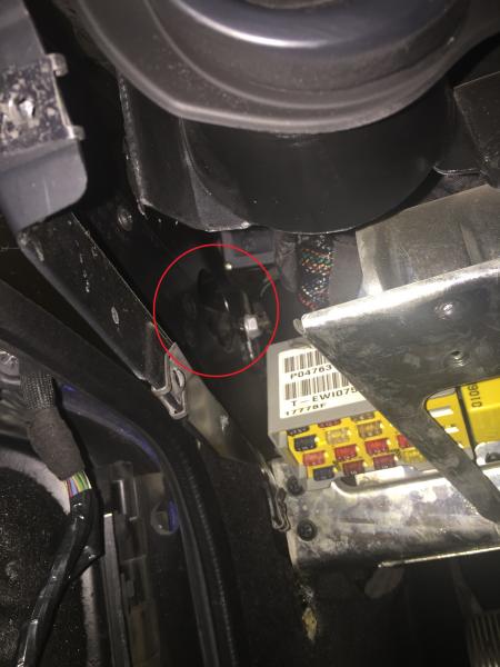

      Once you’ve unplugged it, you can slowly start working the wire out. The wire (at least on my car) wasn’t tied or strapped to anything else, but it doesn’t have a lot of room to move. Additionally, it has to get through 2 holes – for this, we’ll call them the inner hole and outer hole. The outer hole is the one you’re looking at from outside the car – the wiring boot fits into the outer hole and it’s a sort of oval. The inner hole is a circle and it’s inside the car – there’s around a 1 inch space between the inner & outer holes.
      The inner hole is circled here (removing that dash panel allows you to see this hole up next to the fuse block). My harness didn’t have it, but the foam wrapping I mentioned above on my donor harness, I suspect that fits in or around the inner hole.

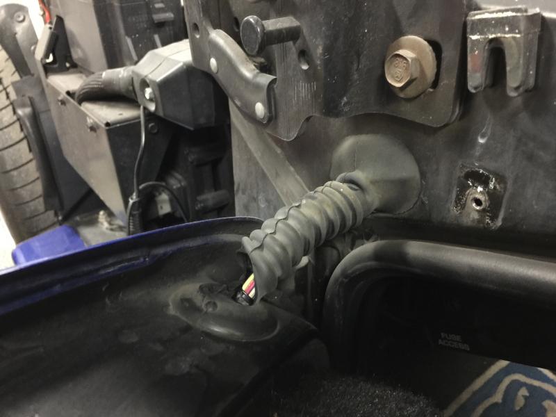

      If you haven’t yet, use a small screwdriver to pry the wiring boot out of the outer hole and you should be able to use your right hand under the dash to somewhat guide the plug while using your left hand outside the car to gently pull the wire out. Once you get past a few obstacles, you’ll be able to see the plug at the inner hole and you can reach up with fingers to guide it through.

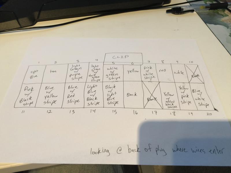

      STEP 6 – DRAW A DIAGRAM!!!!!

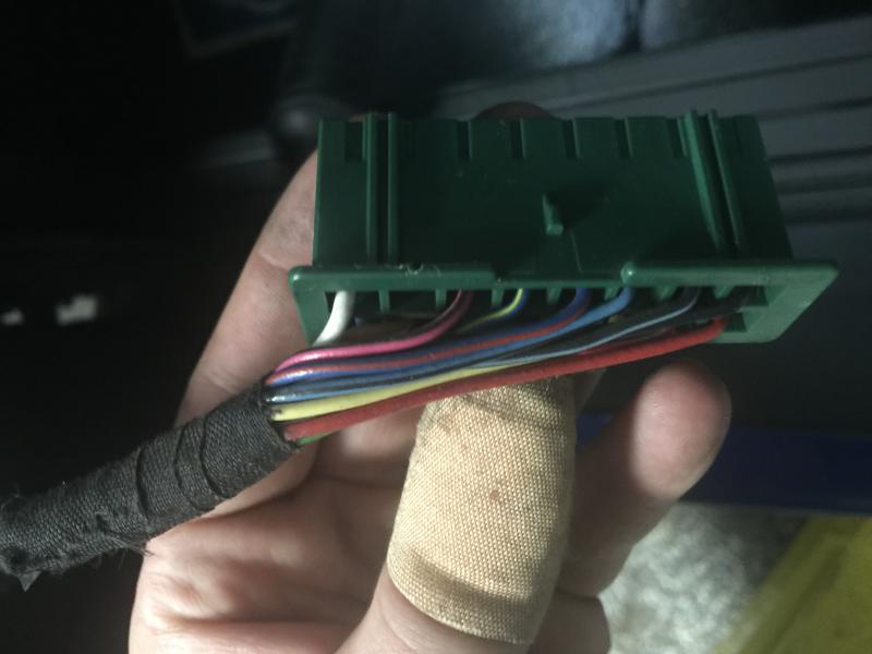

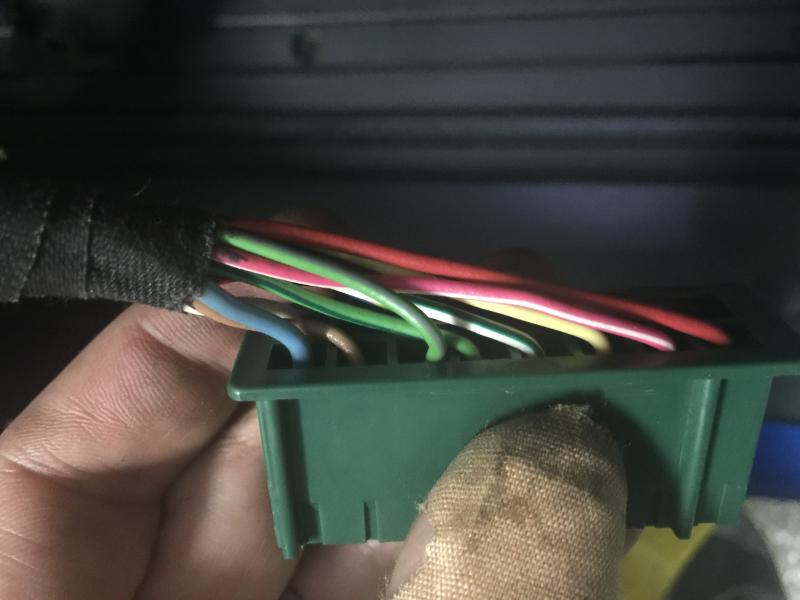

      You are not going to remember where 18-20 wires go. I took pictures of both sides of my plug and drew a diagram of the wiring pattern.
      TIP: On the backside of the plug, each square has a number by the hole – write these on your diagram so you don’t get the orientation backwards. You’d be surprised how easy it is to get it rotated in your head. I actually had 2 diagrams since I initially drew one for the 20 pin donor and then had to redraw a different one once I got mine out of the car and saw that it was different. The one below is from my 20 pin donor (so it won’t match the pics of the plug):

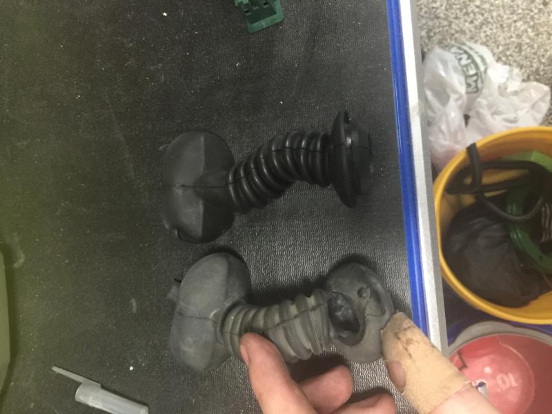

      I found it almost impossible to put the boot on the wires without wrapping the ends in electrical tape first – they kept getting caught on the ribs of the boot or getting caught on one another. Temporarily wrap them in as streamlined a pattern as possible and go slowly sliding your new boot over them. Remove the tape right away and you shouldn’t have made them sticky or anything

      Slide your boot up into position by the door. Again, don’t pull the wires too hard. Also, if you had the foam roll, put that back in place. Re-install the wires into your plug by closely following your diagram (remember how you took the time to draw that – feeling pretty good about life right now aren’t you?). Don’t forget to reinstall the guard (whether yours is the white slider like mine was – 18 pin style – or red 20 pin type)

      Now that you verified everything is working, you should feel especially proud you were clever enough to draw a diagram and follow it! Go ahead and push the boot back into the outer hole and the door hole so it’s all sealed and you should be able to put everything back together again.

      Last tip – 303 Aerospace Protectant is great stuff for helping to protect these rubber pieces from breaking down over time. It will help them maintain flexibility so as to tear less easily. The pic above shows my “new” donor one having been treated with it and I will continue to use it. 303 doesn’t contain a lot of the long term harmful stuff other products like Armor All have. Just google it and you’ll find it on amazon – I think some auto parts places have even started to carry it.

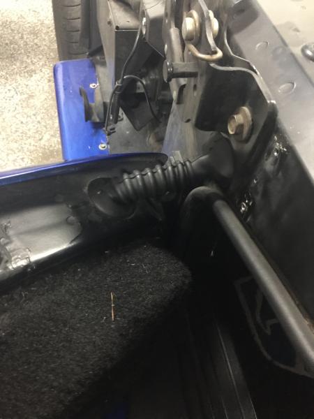

      As my GTS has aged, with many door openings and closings, the rubber boot that runs from the car body to the door slowly started tearing open. Frankly, the boot itself was designed just a little too short, and for many cars, the ribs tend to catch on the gill every time the door opens. This leads to tearing. For this How-To, I’ll be showing how to replace the driver’s side (as that’s the one which takes the most abuse). This is also helpful for people who don’t care about the boot, but are looking for a “how to” on unplugging the door wiring harness from the rest of the car and getting it outside the car body.
