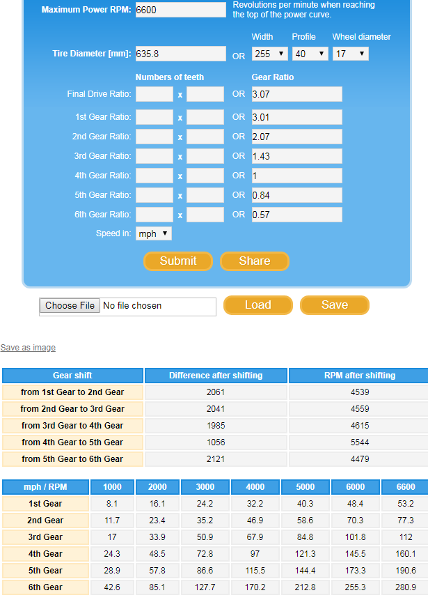

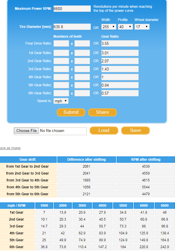

      Also i am currently at stock 3.07, is it worth going to 3.55 or better off staying with the 3.07 to help with wheel spin etc. I have attached two screen shots with the gear ratios.
