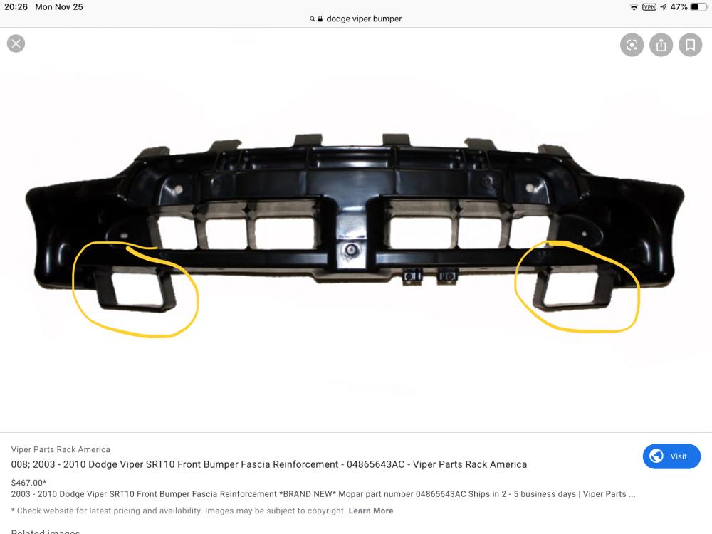

      Understood, I have all that. Do the stock Viper duct holes get plugged? Under the bumper cover, where the stock ducts go, there are holes, where air can pass into the bumper. Does the X have these holes plugged, or does it rely on the rear edge of the splitter to seal against the fender apron?
      These holes are what the stock ducts slip over. On your X, can you reach through them or are they plugged?

      If anyone near an X is reading this, can someone please confirm/deny are these ports plugged?

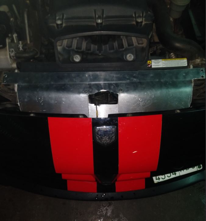

      Took a note from Tom Francis on the closeout panel. It gets hot in Kuwait.

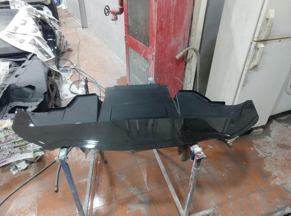

      Track day this Wednesday. I had this made at a local shop. Not easy to come by in Kuwait.
    • 1of1TA1.0
      Post count: 379
      No they are not removed
    • LATAMUD
      Post count: 802
      THANK YOU!

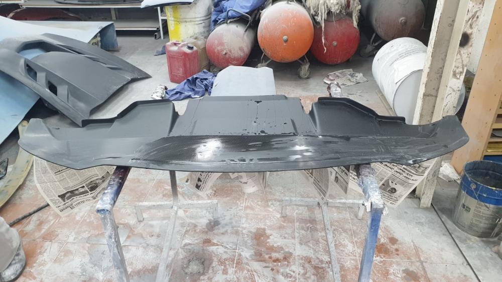

    • LATAMUD
      Post count: 802
      It’s Carbon fiber over fiberglass copy of an ACR splitter, a little heavier than the full cf piece. For $600 I’m not complaining.
    • 1of1TA1.0
      Post count: 379
      Looks pretty good actually!

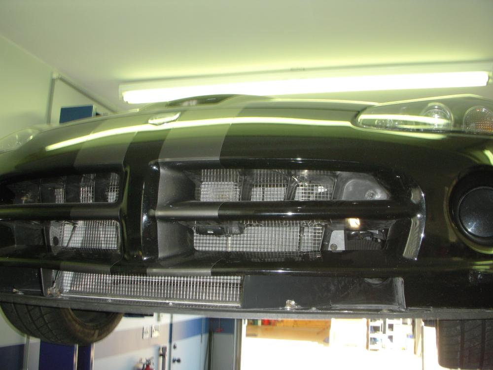

      I’m adding the ACR-X ducting to a 2008 Coupe, will be cutting the lower lip of the bumper cover and adding a splitter. Do the stock Viper duct holes get plugged? If so can I just cover with a flat plate? I heard the stock ducts cause the front to lift. Yes, I own an X but not home to look at it, and haven’t owned it long enough to memorize all the differences on it.
