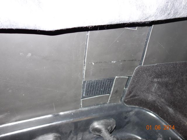

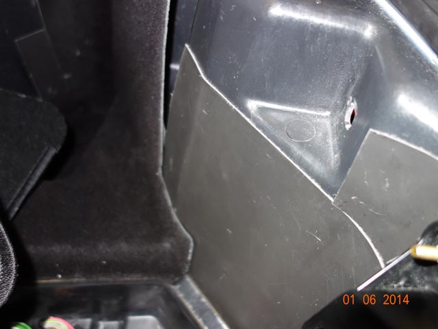

      The pics below show the sheet material that I used on my SRT, It looks like a Frankenstein rendering. The problem is the trunk is cut up and has very few flat panels. It is basically cut and paste with a set of scissors. The whole trunk took about four hours. I bought two of the 12 sq ft rolls from Summit and have some left over. I am going to look at the area behind the seats next.
