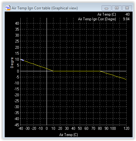

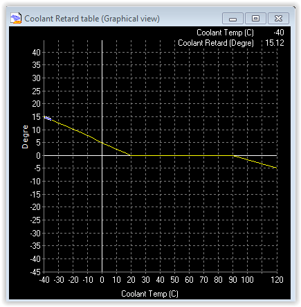

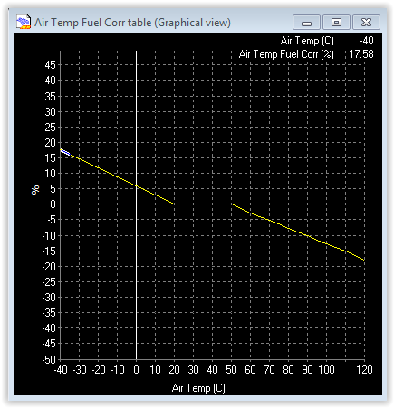

      I’m using a AEM v1 stand alone on my 97 GTS N/A.
      What do you think about the following graph ? Your data are similar or not at all ?
      Air temp Ign Corr table :
      Coolant Retard table :
      Air Temp Fuel corr table :
      Be aware that my X axle is on °C not °F, but the shape of the line should be equal.
