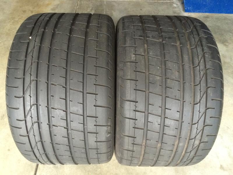

      Maybe you got 2 “lefts”.
    • Special Ed
      Post count: 901
      The corsa’s and the P zeros and not left and right only. They only are marked as to which side is mounted out.
    • TooBlue
      Post count: 521
      Red Snake said:
      Maybe you got 2 "lefts".
      There “asymmetrical” so there isn’t a left or right. (in theory)
    • TooBlue
      Post count: 521
      Special Ed said:
      The corsa's and the P zeros and not left and right only. They only are marked as to which side is mounted out.
      That’s what I thought also. I have the “outside” mounted out. I just thought it was odd that one side tire would divert water to the center of the tire (crating a hydro plane effect) while the other side would divert water away from the center of the tire.
      I do realize that Pirelli states the the tires are NOT left/right specific.
      The side-to-side cuts in the rubber are not diverting water to the inside or outside of the tire, they are diverting water in both directions to the wide grooves cut around the circumference of the tire. Thus, it is unimportant what direction the side-to-side cuts are tilted towards.
      I had the rear tires off the car and had a question. I know the tires are directional and I have the “outside” stamp mounted to the outside.
      However, I noticed that the outside pattern on the left tire would divert water away from the tire center while the inside tread pattern would diver water away to the inside edge of the tire away from the center of the tire.
      On the right side tire the outer tread pattern will divert water to the inside of the tire and the inner tread pattern would divert water toward the center of the tire also creating a hydro plane effect…???
      I know the tires are marked “asymmetrico’ but the tread pattern looks to be left/right specific.
      There’s probably a simple answer for this but I don’t see it. What am i missing?
