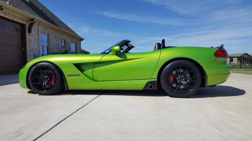

      FrgMstr said:
      I replaced sway bars on my Gen IV and put MCS singles on the car and have been very happy with it for rallies, autoX, and track days. MCS are nicely adjustable too when wanting to load up the trunk for rallies and weekends out and about. Car still very drivable on a daily basis IMO. I have done sub-2m40s laps at CoTA with street tires on MCS and always felt confident in the corners. I am not a "track rat," just casual, so what do I know?
      Your car is beautiful, love the color match, congrats

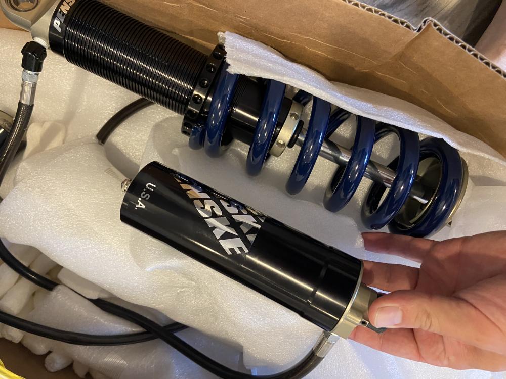

      Got my Penske double w/Hyperco springs, will get them installed next week along with that:
      https://tkomotorsports.com/product/viper-rear-lower-shock-mount-with-spherical-bearing/
      Can’t wait to see/feel the result!
      Baller.
      Random tip: my MCS shocks can be hard to install when the canisters are pressurized. You can release the pressure to help with this, but of course, you need to have the right equipment to refill them.
      Other than that, it should be a pretty easy install…the adjustable perches make all the difference since you don’t have to screw with spring compressors.
