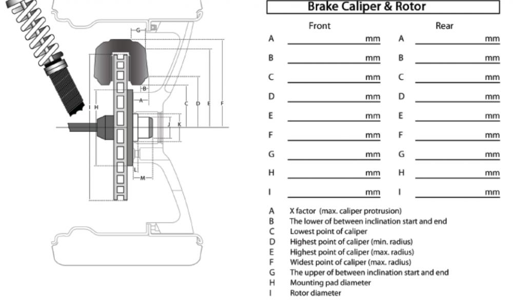

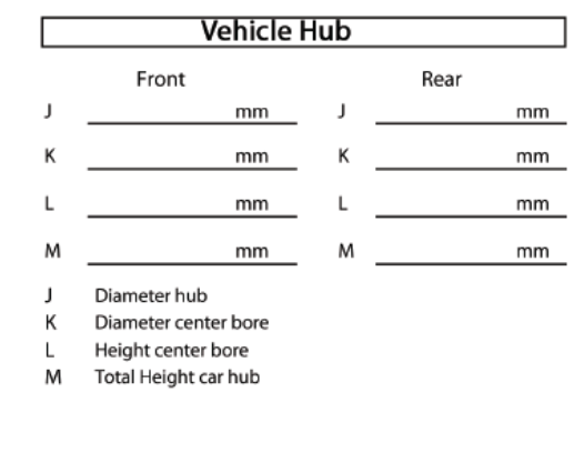

I’m getting some wheels custom made for my Gen V and am getting asked for brake specs. A) Is this a normal thing for people to ask for? B) Does anyone know where I could get this info? Basically asking me to fill out the attached and don’t know if I need to take the current wheel off to measure.
Any directions to point me to?
