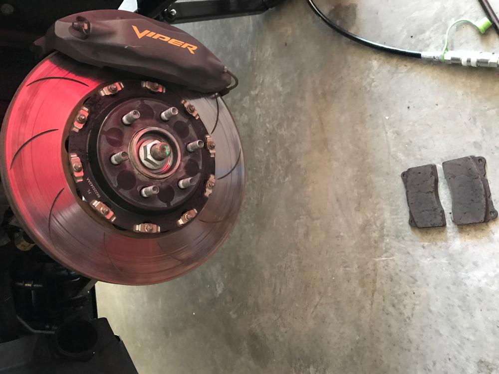

      Had grooves and the front passenger side was groaning under light brake pressure. Don’t have close-ups of the surface before dropping them off to the machine shop.
      Ordered a set of AP-Racing j-hook rotors to discover they do not fit my 2014 TA1.0 with the deeper Brembo rotors. Decided to have the original OE Brembo rotors resurfaced to use on street and backup. The front rotors measured 31.6Xmm (32mm new) before resurfacing. Don’t have the measurements post resurfaced as the machine shop still has them, but they shouldn’t be much less.
      Wanted to get thoughts on whether I should use the resurfaced OE Brembo’s on track, assuming they are above 30mm.
