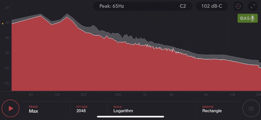

      Also I’d like to point out that 65hz is the peak sound pressure level, as shown on the graph, but you can see that levels are still very high even below 30-40hz and maybe there is subsonic frequencies, which are good for IMAX theaters but not so much for road trips…

      Where it starts to be tricky, is if you’re concerned about racetrack SPL limits.
      Problem is: peak SPL will probably happen at higher frequencies at WOT. But lower frequencies travels farther and are omnidirectional.
      So you basically have to know where the racetrack’s microphones are placed. Since the higher frequencies are more directional, you might have a loud exhaust but be ok if the pipes are turned up or anywhere but directly at the mic direction.
      With lower frequencies, you basically have no control since the rumble is omnidirectional and can be heard from longer distances. So a resonator might be the only option. In my case, as you see in the graph above, I don’t even need to go to my racetrack to know that I’d be kicked out. Both peak SPL at higher frequencies and low frequencies will trigger the mic’s limit. With a resonator I might have a fighting chance.

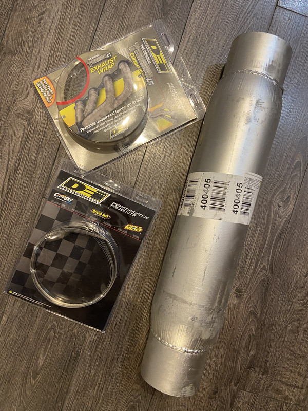

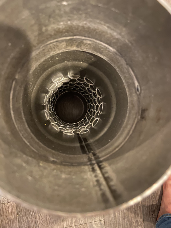

      Diamond Eye 4” resonator. Will get the thing installed and heat wrapped, hopefully it will reduce the lower frequencies at least 5-6db and also a bit of the higher frequencies….

      As expected, the thing is loud. We probably can say ”crazy loud”. Didn’t soundtest at WOT but I wouldnt be surprised if the thing would make 140db SPL at 1 meter distance, if not more. In-cabin at idle, it shows on my app a 102db rating and even though the app may not be perfectly accurate, it makes sense. Now, the problem is not really the high sound levels, it’s the frequencies….
      As you can see, it’s all low and very low frequencies. That’s what is commonly called ”DRONE” noises. The problem is: the Viper engine is huge. Therefore it produces lots of low frequencies. Pretty much like big diesel trucks. I sure can feel in the cabin ”subwoofer” kind of frequencies, which means 20-30hz. That’s very low and very annoying. I did a 3 hours roadtrip and the constant low-freq rumble was deafening, so I had to keep the engine in higher rpms to change the resonant frequency…

      So I ended up with a Diamond Eye Performance 4” resonator. 24 inches total lenght, installed after the Vibrant muffler, so its aligned with the seats, just before the exhaust exit. It’s a resonator usually used for trucks but it shouldnt stop you from using it on a Viper. If you want to get rid of the annoying noises but don’t want a restrictive muffler, the options are very limited.
