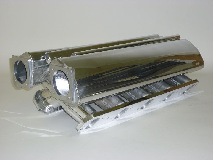

      with the Hoogan s intake manifold , myonly worries will be to custom build a remote Idle air control, with the stock one.
      on the back of the intake I have 2* 3/8 hole so I can plug some air hose no pb.
      Anyone used a custom made intake manifold here ?

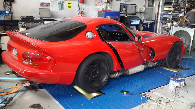

      Hi everybody,
      Just a quick thread to introduce my Vip :

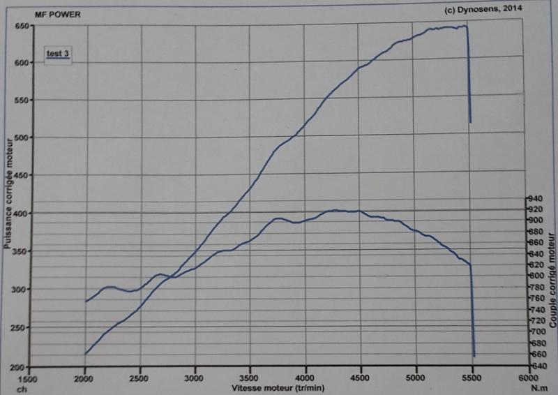

      It make 642hp @ 5450rpm (flywheel corrected) and 922Nm @4300rpm
      I already brought from Hoogan’s racing a new Intake Manifold, and next purchase will be a JMB airbox. I hope I could reach 675hp (flywheel).
