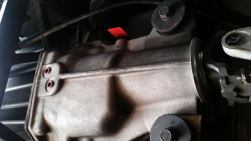

      I pulled both. One seemed to be a little lower than the other and drained after the other had stopped. They’re easy to deal with so might as well.
      Yeah good call SA Heat. That’s what I ended up doing. You’re right…definitely more coming out of one side.
      Good deal. The extra hole is for diff cooler plumbing in case you were wondering.
      Oh ok. Yeah I was curious what it was for. Thanks! At least I don’t have to fill it through two holes…lol…
      Okay I’m about to pull off the drain plug for the rear end but…there are two of them? Please look at the pic below. Do I pull both or one? If so, does it matter which one? Thanks!
