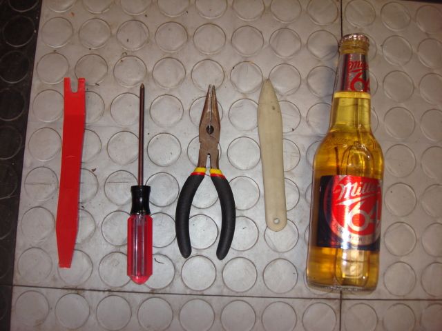

      TOOLS NEEDED: *Note, these are what I found useful. You may need more, less or different tools (I will touch on that later)

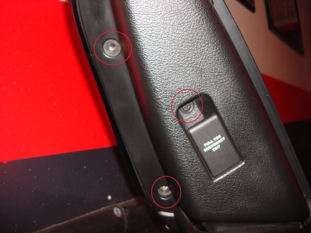

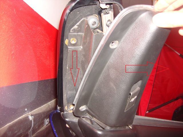

      The First step is to remove the THREE screws holding the inner trim panel to the stanchion (phillips head). Be aware, the screw right above the door release can fall through the trim and POSSIBLY down into the door. Make a special effort to hold onto the screw as it loosens up, just in case
      After removing the screws, press DOWN on the top of the inner trim panel and FORWARDS (towards the front of the Viper) to remove the trim panel from the stanchion. It’s going to be tight and annoying. TAKE YOUR TIME. I used a body trim removal tool to work around the trim panel until I felt it release.

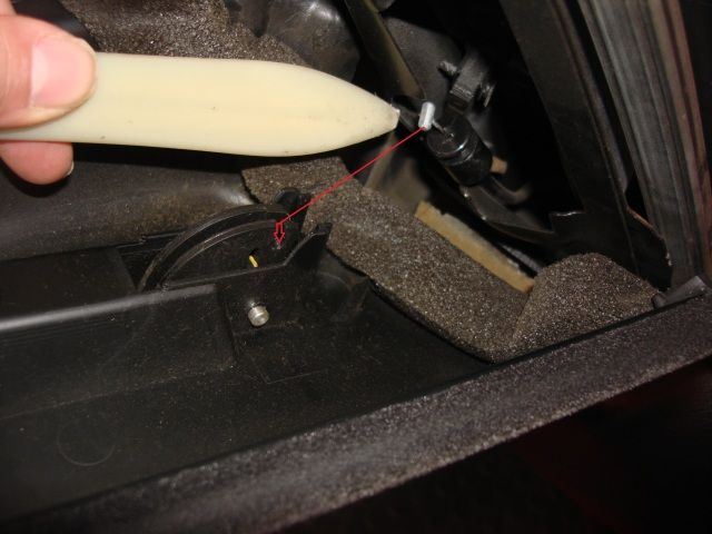

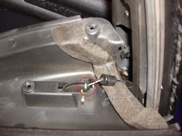

      After you remove the trim panel it will still be attached by the door release metal cable, this is what it will look like (from the driver’s seat)

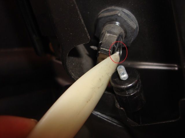

      You will next simply remove the release cable end from the trim panel door release handle (think of it as a ball and socket, you’re just going to use your fingers to remove the BALL from the SOCKET

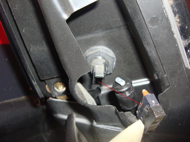

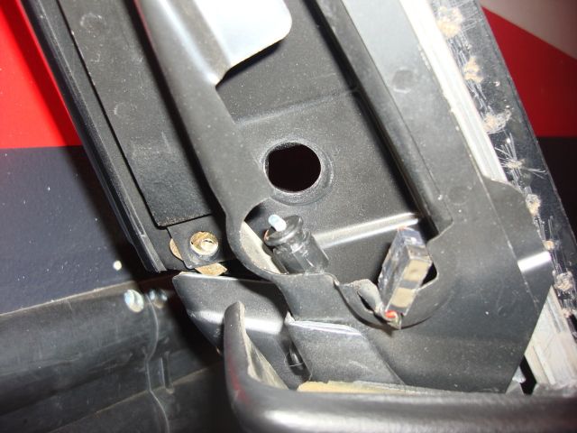

      Next, you’re going to see the door latch release solenoid wiring connector. In English, you’re gonna see some wires leading a black box. The black box is held on by a push-pin looking screw. Remove the push pin looking screw with your fingers/ trim removal tool. Pull the box from the socket and push the (now loose) black box to the side.

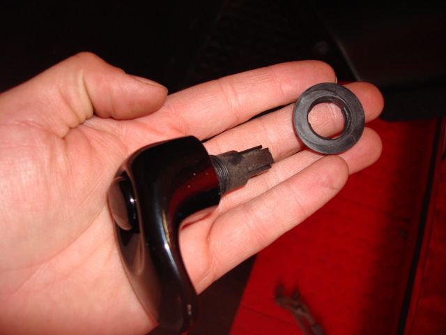

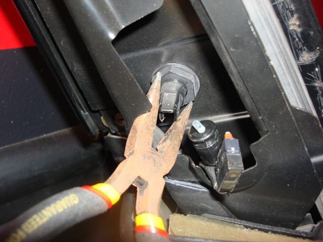

      You will now be looking at a big, black, plastic nut holding the outer door handle to the stanchion. Time to remove it. You can either use a needle nose pliers OR a 15/16 deep well socket. Once the nut has ben removed, reach around the door and take off the door handle. You will now be left with a big hole and a wide open stanchion

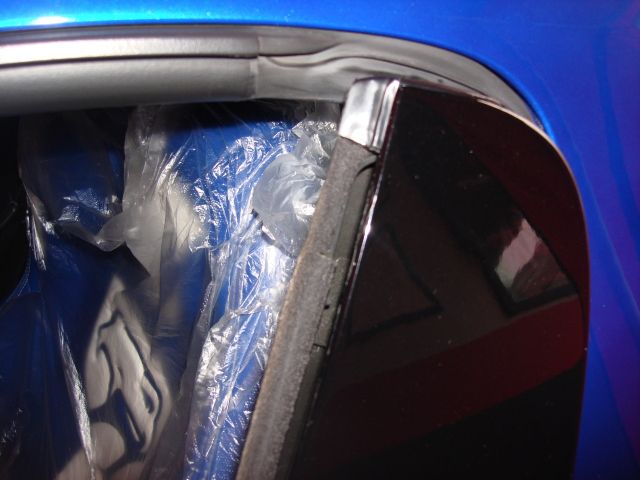

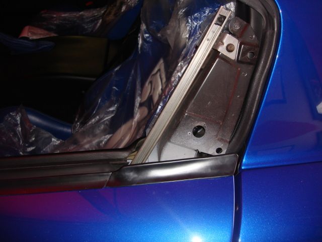

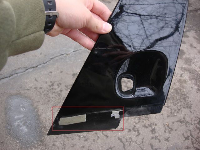

      Now, you can remove the stanchion from the door by pulling up and wiggling it until it slides out. NOTE: As seen in the picture, yours may have some kinda 3M tape on it as well. You must be very careful that you do not rip the outer run weatherstripping as you are pulling the stanchion up and out. Use your fingers or a PLASTIC putty knife and go slow. You will know exactly what to do when you get to this point.
      Note above: The outer run weatherstripping that the 3M tape was stuck to. I had to peel it forward slightly to release all the 3M tape and then peel it back against the painted portion of the car.

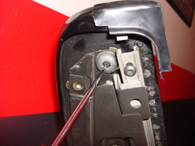

      1)You are now ready to reinstal your new stanchion, simply reverse the above steps. Before reinstalling you must make sure that the door stop is all the way in its DOWN position, or else the window will rip your new seal (The “door stop” is held onto the metal slider by the black Torx head screw)
