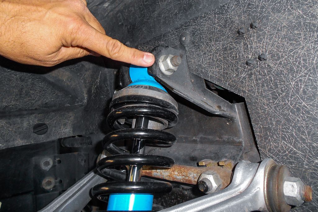

      Ok so now the shocks come out over the top. In order to get the bolts off you’ll need a good pry bar or a long lever to get the lower control arms pushed down a bit. I used a long breaker bar and slipped one of the floor jack bars over the end to give me a longer leverage arm. Don’t need a ton of force, but it makes for an easier job.

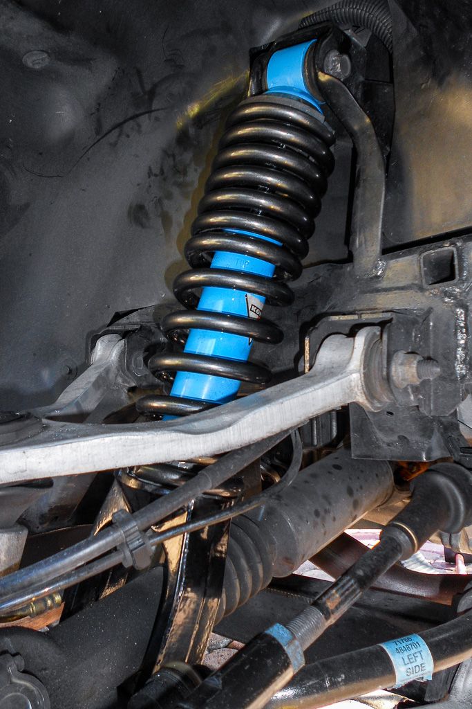

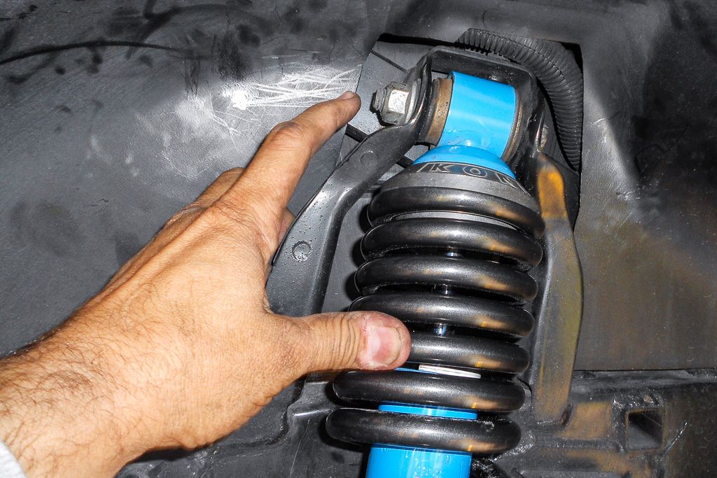

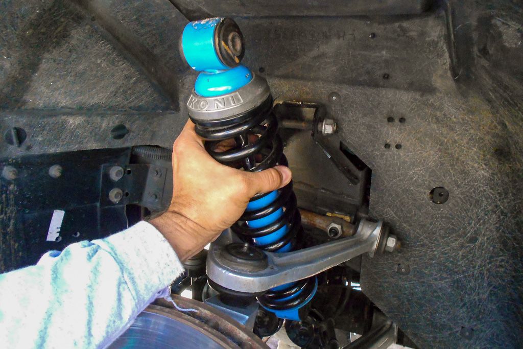

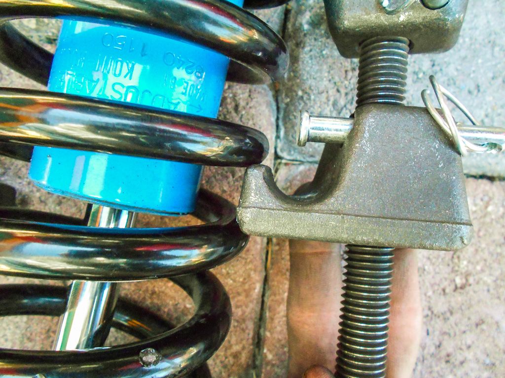

      This is the front shock with the stock spring on there. Looks easy but the problem is the coils are too close to get the typical strut spring compressors in there. I eventually took the springs to a shop… more on that in a bit… for now the stock shock, spring and the compressor. You’ll see it does not fit without damaging the spring and the body of the shock.
      The rears are identical except that the lower mount has a fork to allow the half shafts to go through to the rear wheel hubs.

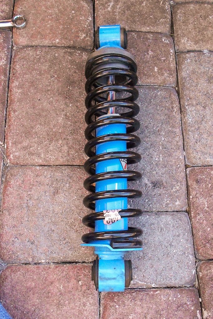

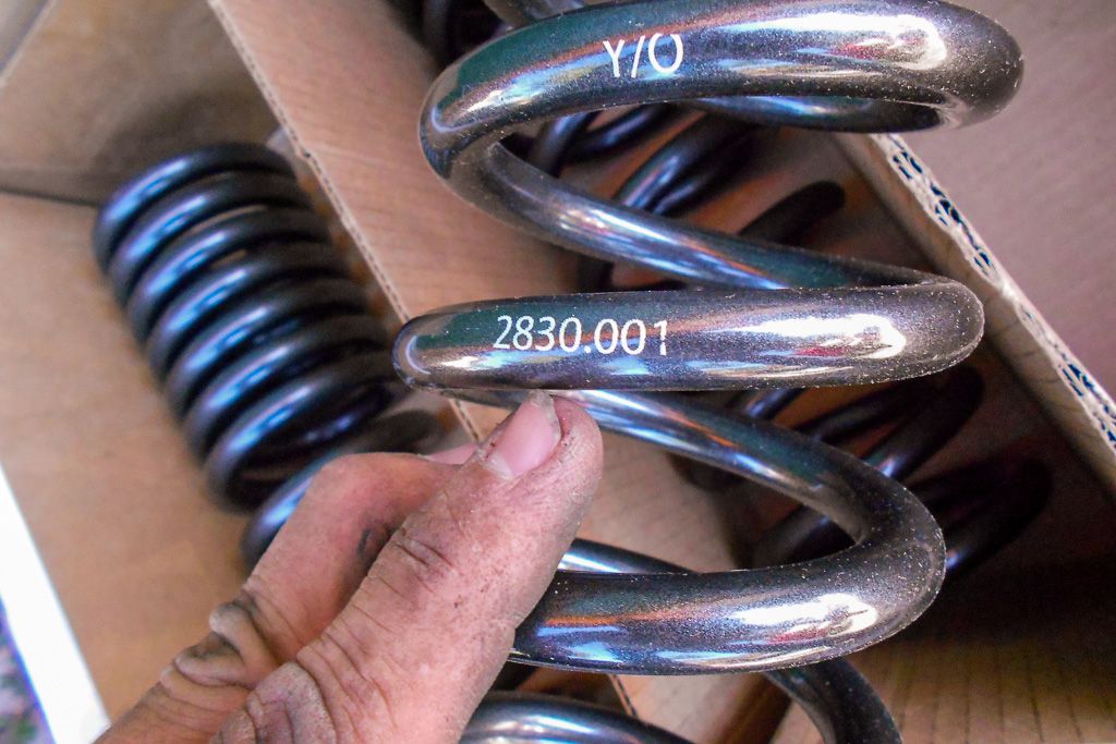

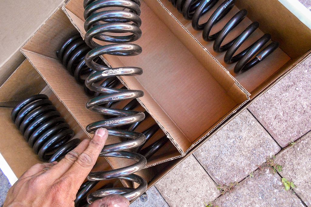

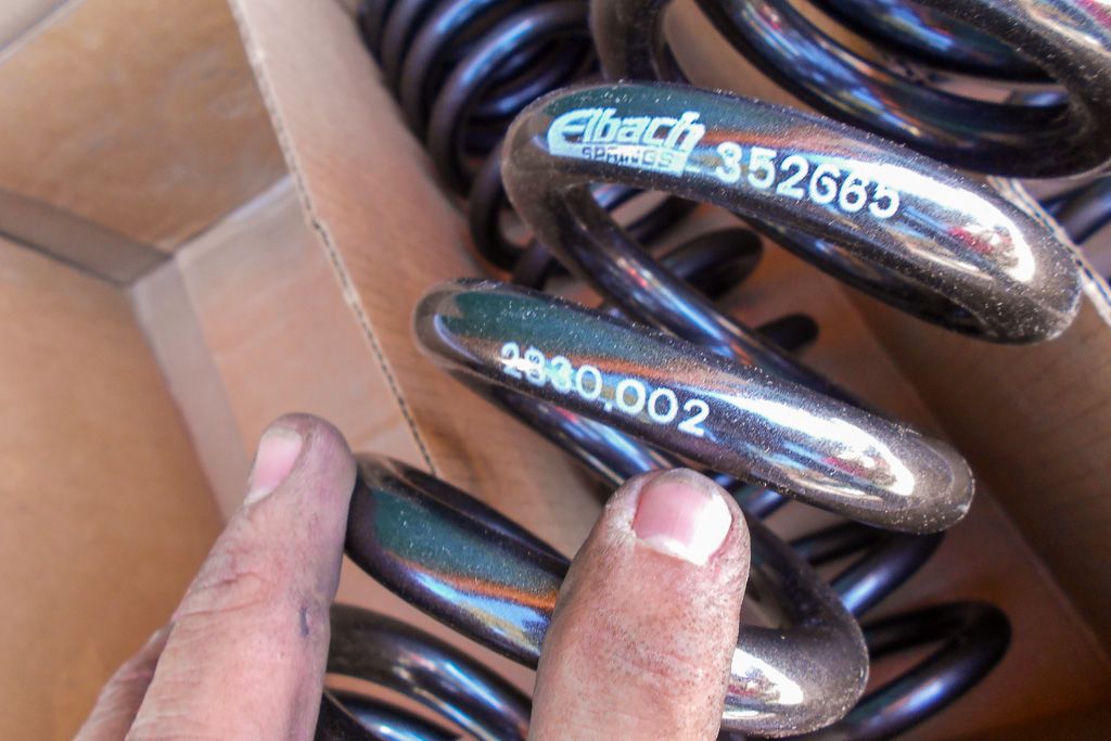

      Below are the photos of the new springs. I just put those just to show that the fronts and rears are different. They do have different rates and coil designs. You can see the difference in length but in addition to that Eibach is kind enough to designate the springs with numbers. The 001 springs are the front and the 002 springs are the rears.

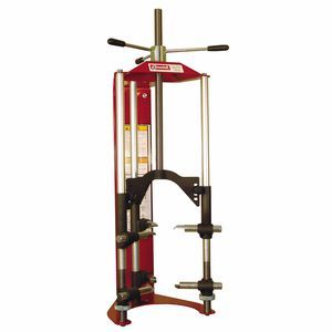

      You have a couple of options for the springs. I went to a shop (buddy of mine in Miami and a member in a club I am in) that has a wall mounted strut spring compressor. The catch is that not all wall mounted compressors work. The main issue is the rears. Since the rear Eibachs are variable rates (hence the tighter upper coils) you have little to grab onto to compress. What you need is a compressor that has an “offset” top or a hole on top so that as you compress the top of the shock clears. I grabbed a shot of the one my buddy has as an example. While tough to see, the screw on top that pushes down is offset from the center line such that the shock will clear. Remember, the shock’s center line and the spring center line are the same for the coil overs.
      The jaws or bars mounted on the moving, upper part/carriage are tapered so that they fit between the coils safely without marring the finish. It really is the easy way to go.

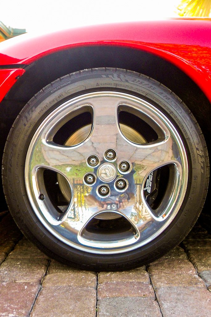

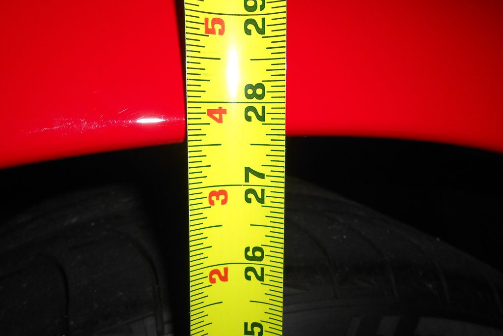

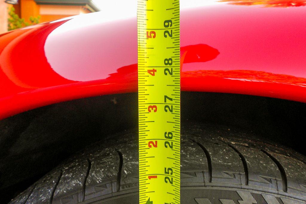

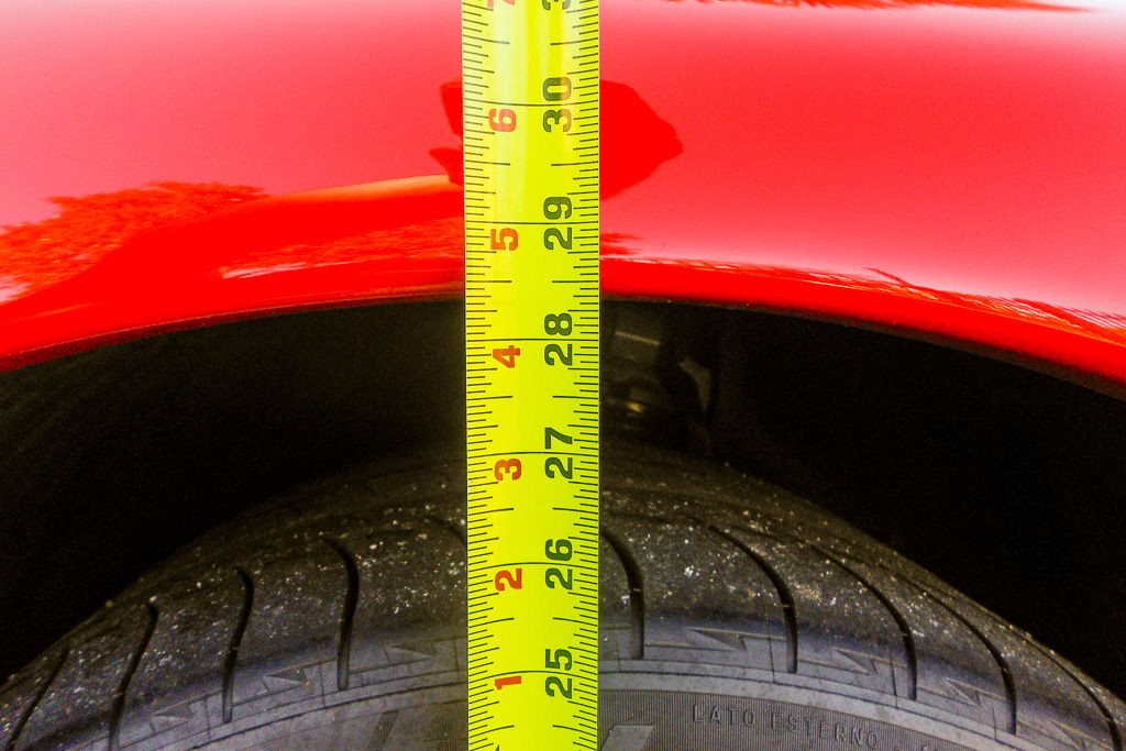

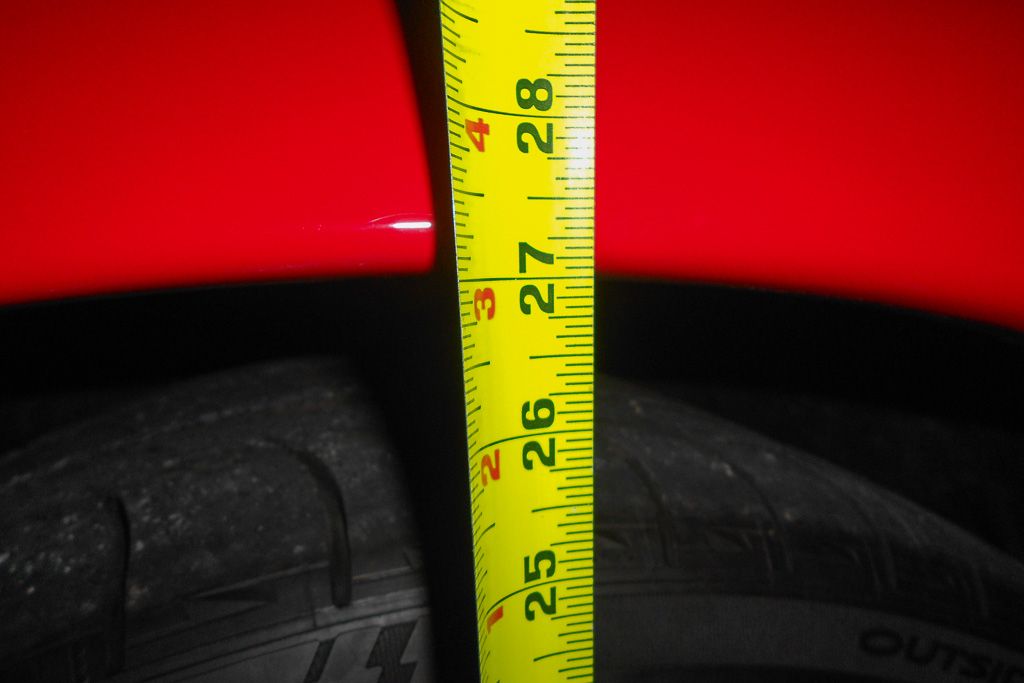

      So now some before and after shots. I’ve seen folks measure gaps before, but that never makes sense to me. The better, more accurate and, frankly easier way to do that is to measure from the floor. If you don’t change wheels and tires then the wheel diameter is fixed. In short the top of the tire is fixed. If you measure to the top of the wheel well then you will know what the drop is and you will not make a mistake by not holding the tape measure at a different angle ect. So now that I have cleared up that I am a nut… :rolaugh:… here is the before ride height to the wheel well.
      These are the BEFORE shots. The first shot is the rear wheel well. The front is the next shot. Notice there is a one inch difference. However, don’t worry about it. The important thing to see is the before and after.

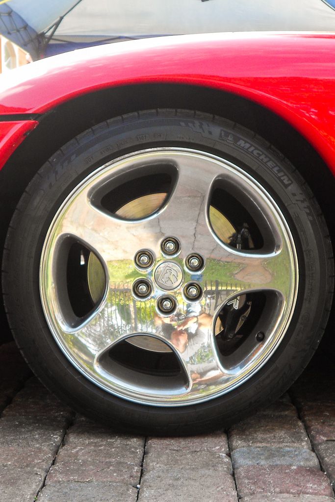

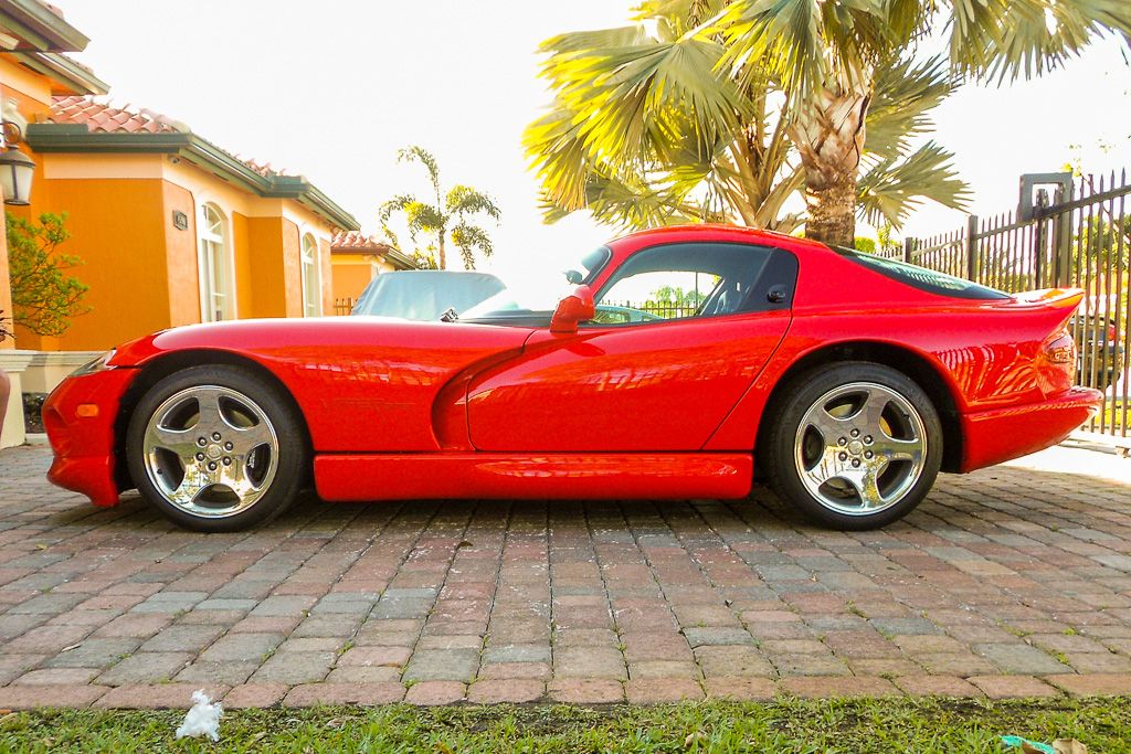

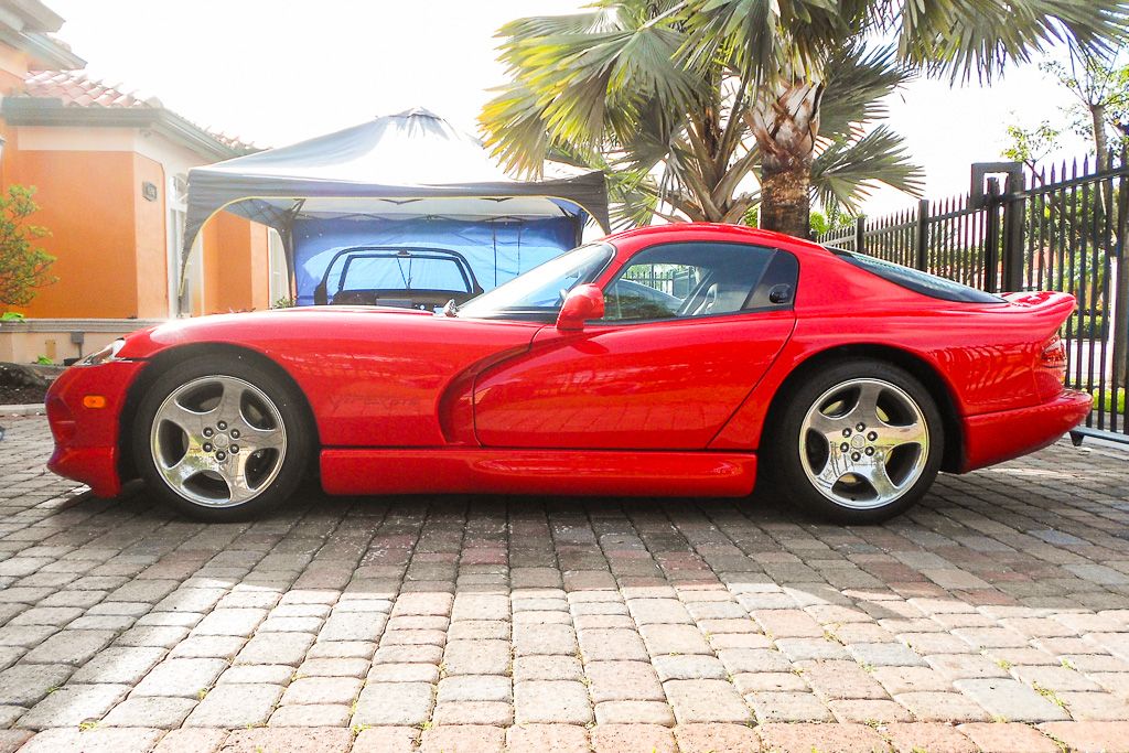

      These next two shots are the AFTER.
      The result was a one half inch drop up front and a full inch on the rear. This was shot after a drive in the evening. The springs will continue to settle a bit and I may get another 1/4 of an inch or so all around as the springs cycle a bit more. It has happened with all other cars I’ve lowered to date. But let’s see… I will let you know. Regardless, the difference is VERY NOTICEABLE. You can see the gap significantly reduce. Here are more shots.

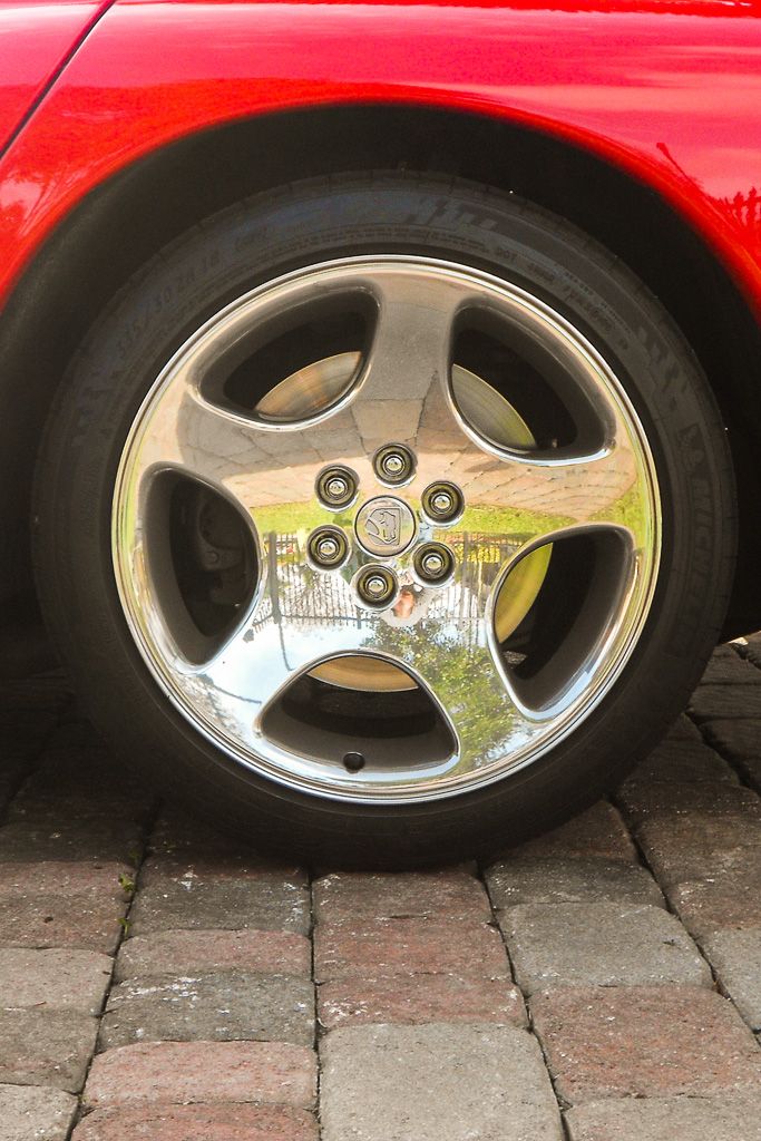

      Front wheel shot BEFORE and then AFTER.

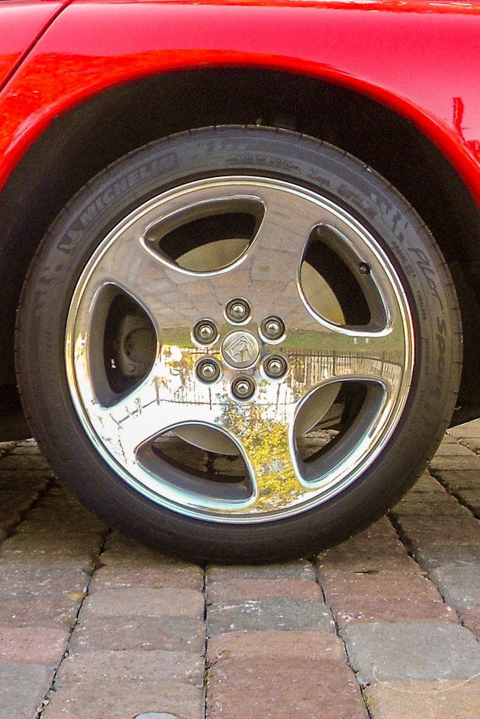

      The rear wheel shot BEFORE and AFTER. This is what I had a huge problem with. Definitely looked bad with the huge gap.

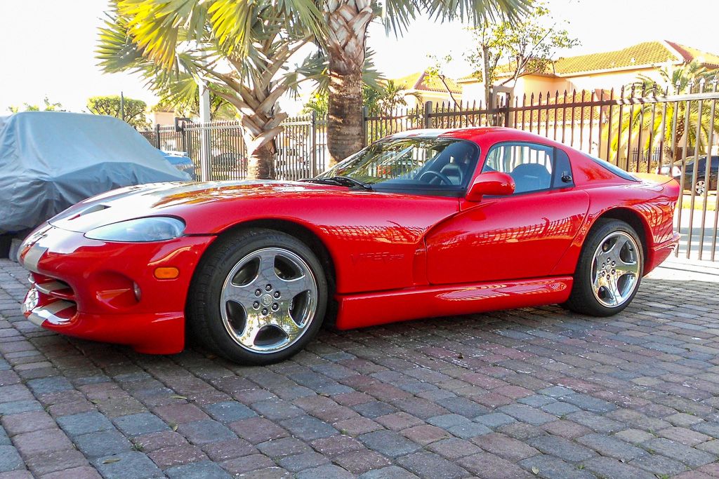

      Here are the last before and after shots. A pair of shots from the side and then off at a slight angle. While not perfect, it should give you all a great idea.
      The angled shots…

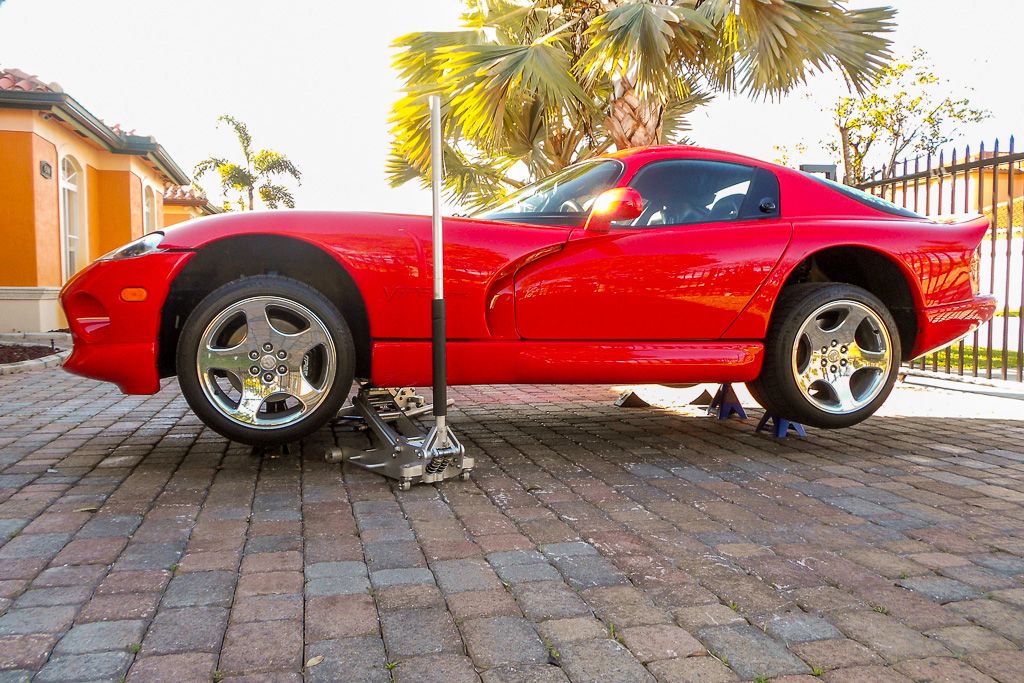

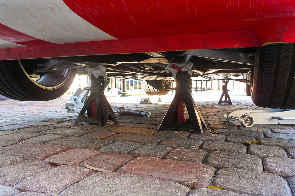

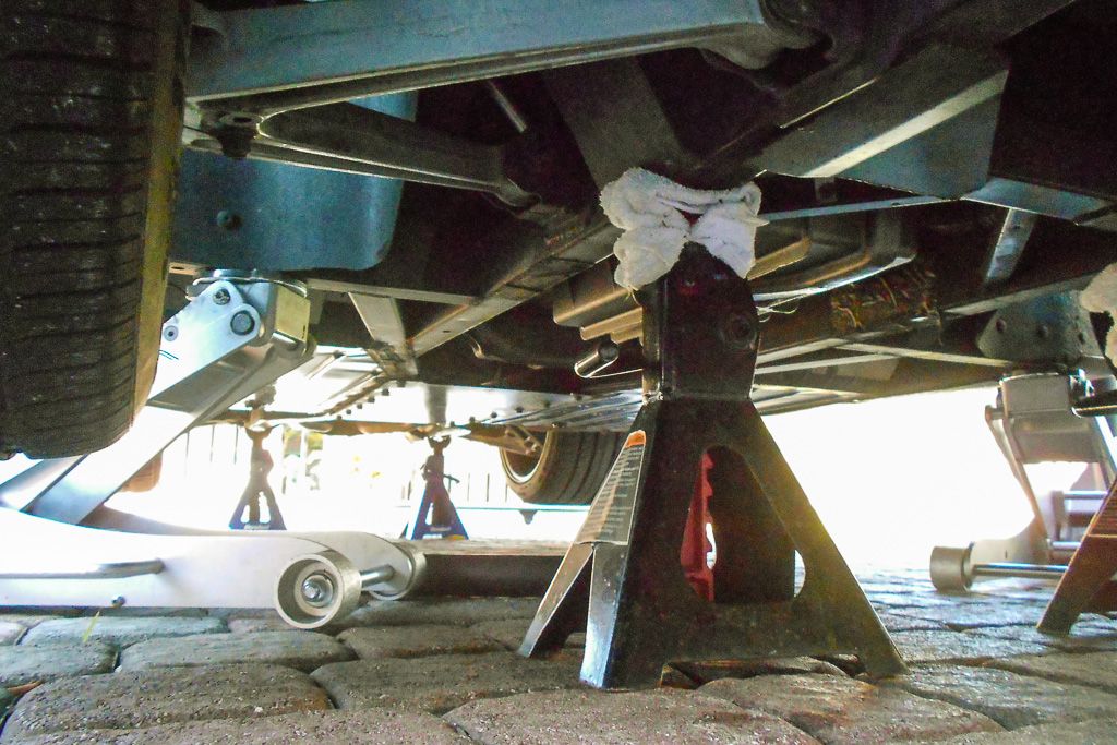

      I have the benefit of two floor jacks. As a result I lift the front and rear with two jacks at a time. This way, i lift it evenly and I don’t tweak anything. I lift the front first then the rear. Once it’s up on the four jackstands, I put the floor jacks at the front lift points and just pin them in place. They are just there as safety/backup and to give it more “left to right” stability.
      Here is were I place the front and rear jack stands.

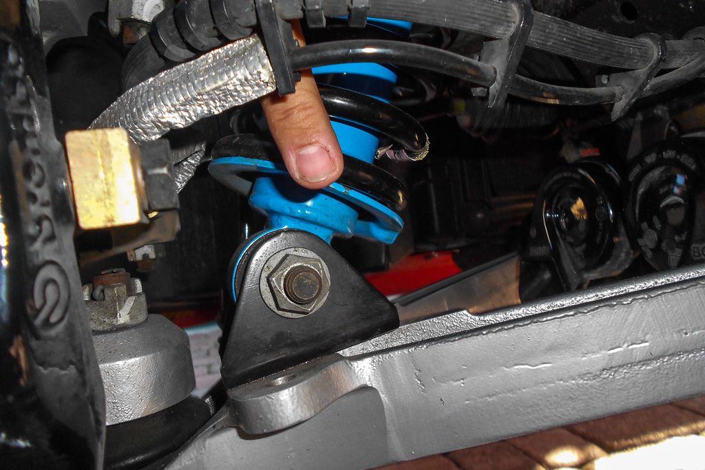

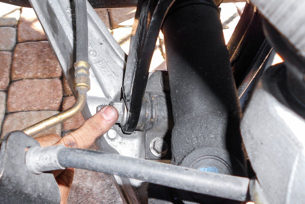

      Since the car is on coil overs (although fixed) replacing the springs is basically just a matter of getting the shocks off and then swapping out the springs. To get the coil overs out requires the removal of two bolts per corner. If you want to make life a bit easier, on the fronts, you can remove the sway bar links from the lower control arm. This allows for easier removal of the lower shock bolt. I did that. What I discovered in the process is that the boots don’t last 10 years. The links are perfect on the sway bar tie rods, but the boots are damaged. I’ll upgrade/change those later. For the sake on completeness, I’ve included a shot of the four bolts, two for the front and the two rear. However, it’s obvious when you look in there.
      Front top and bottom bolts.
      The rear top and bottom bolts. Yes, this is after they have been replaced. Those are the new springs.
