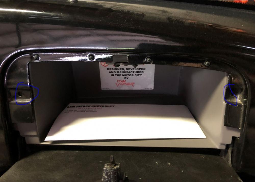

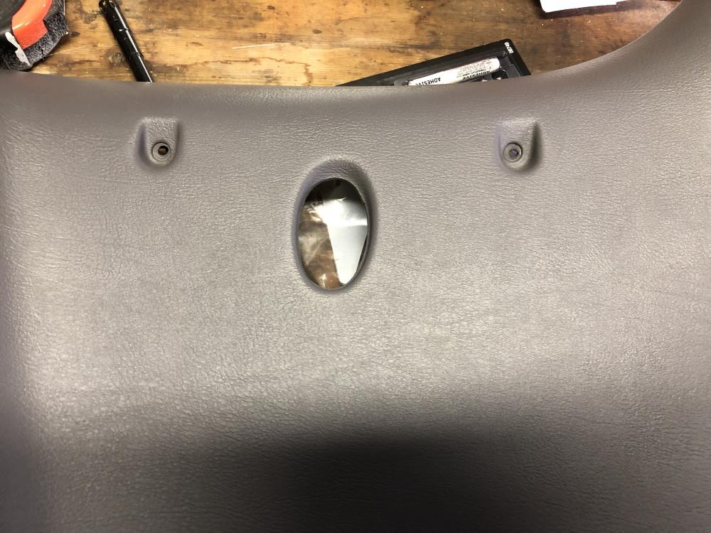

      More screw locations. There are some pictures that I left out, but you can see most of them. Plus a couple near the radio, I believe.
      Kick panels:
      Both sides of the car next to the door

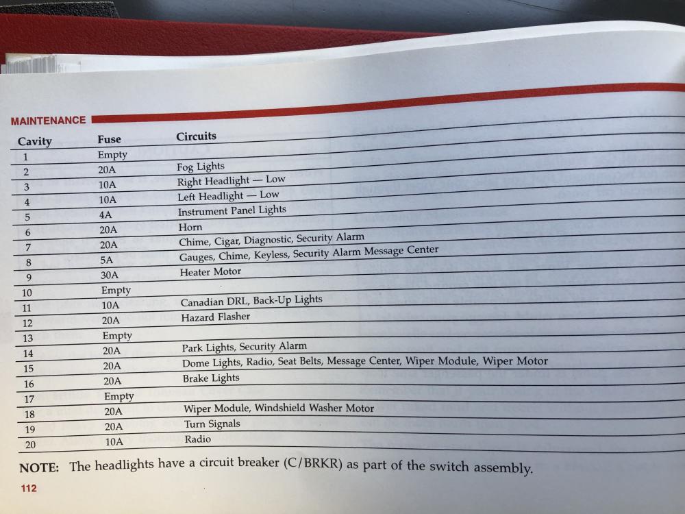

      1) I was scared to disconnect the battery, since I heard all these horror stories about the alarm and PCM settings. So, according to the service manual, you can pull the corresponding fuses instead, which is what I did.
      Remove anything related to the dash as well as the lights (more on this later). So that is 2,3,4,5,7,8,15. (Fuse reference pic coming soon.) The fuse box is in the passenger area under kick panel.

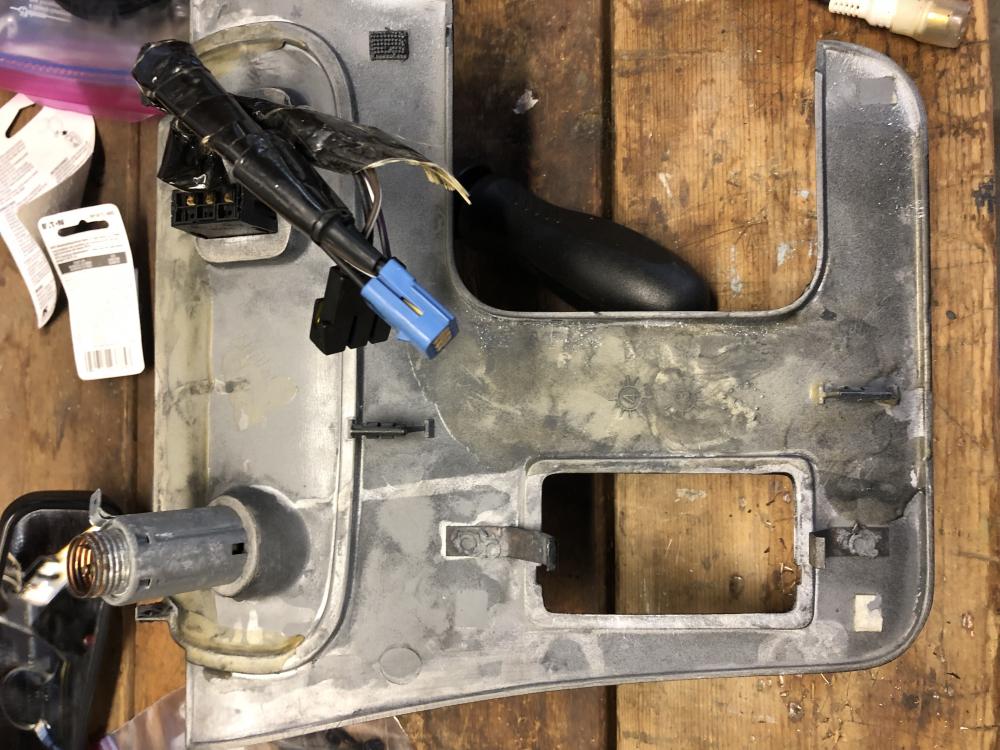

      2) First trim piece to remove is the Heater/Radio bezel. This was already somewhat loose when I got the car, so I don’t have many details on it. I don’t remember taking any screws out, but please look around and make sure there are not any. Take your time with all these trim pieces, and I would recommend not consuming adult beverages during this process.
      You need to remove the ash tray first. Then I remember it just popping out. But, of course, I cracked this one, so be very careful and try to grab the strongest corner first. Once it is out, there are plugs under the fog light switches and connectors on the “Cigar” lighter (love how they call it that. I guess you must have been rich in 93 to own one). Remove the +/- connectors of the cigar lighter, then the plug for the fog switches. Mine was buried and I had to pull it out. I also noticed I only had one plug, but the manual says there are two.

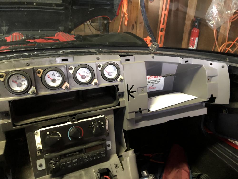

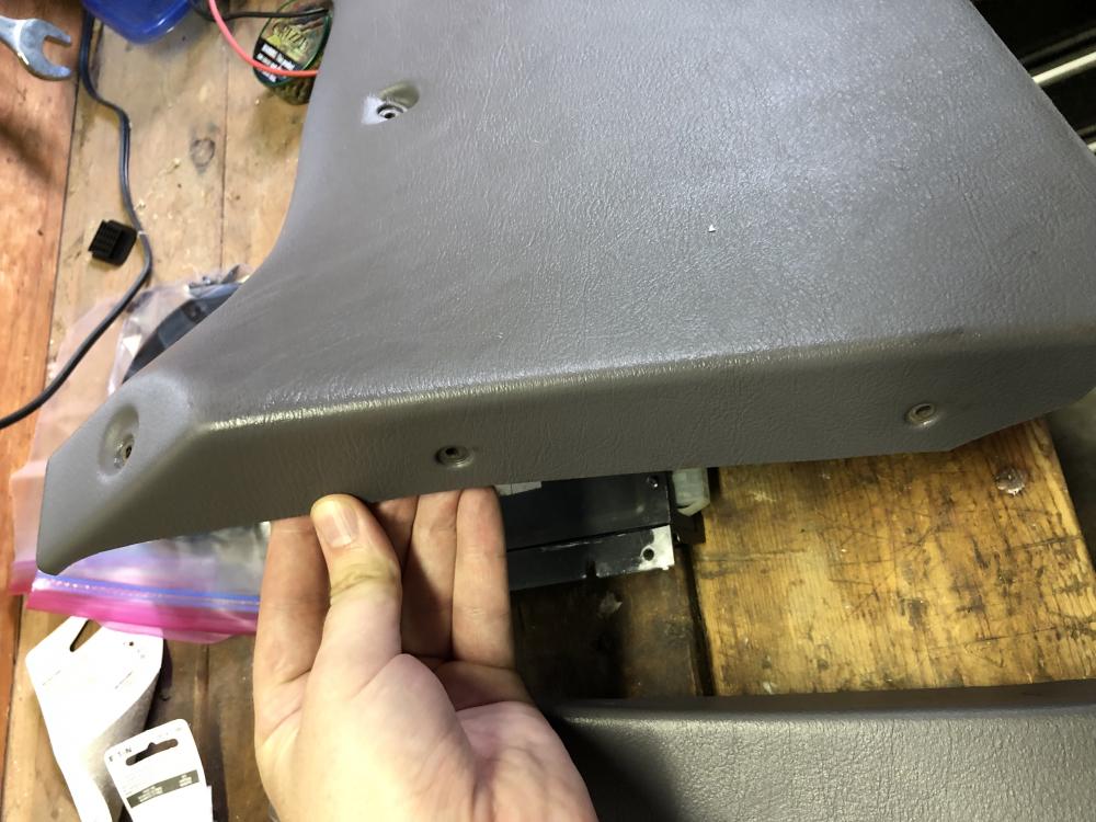

      3) Take out all the Philips head screws from the left and right kick panels and the dash (there are two in the glove box). The kick panels are fairly easy. A few on the side and two underneath. I’ll post pictures of the screw locations to follow.

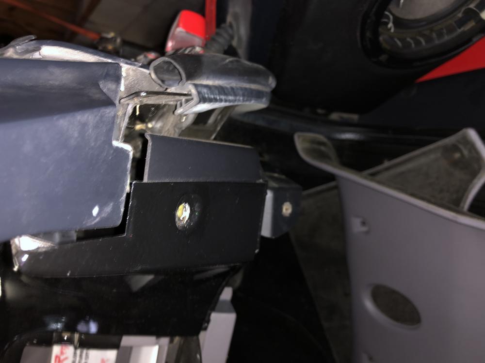

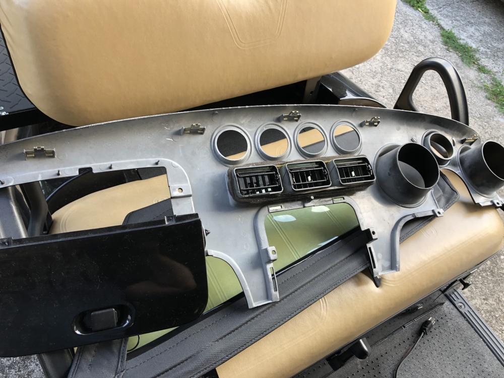

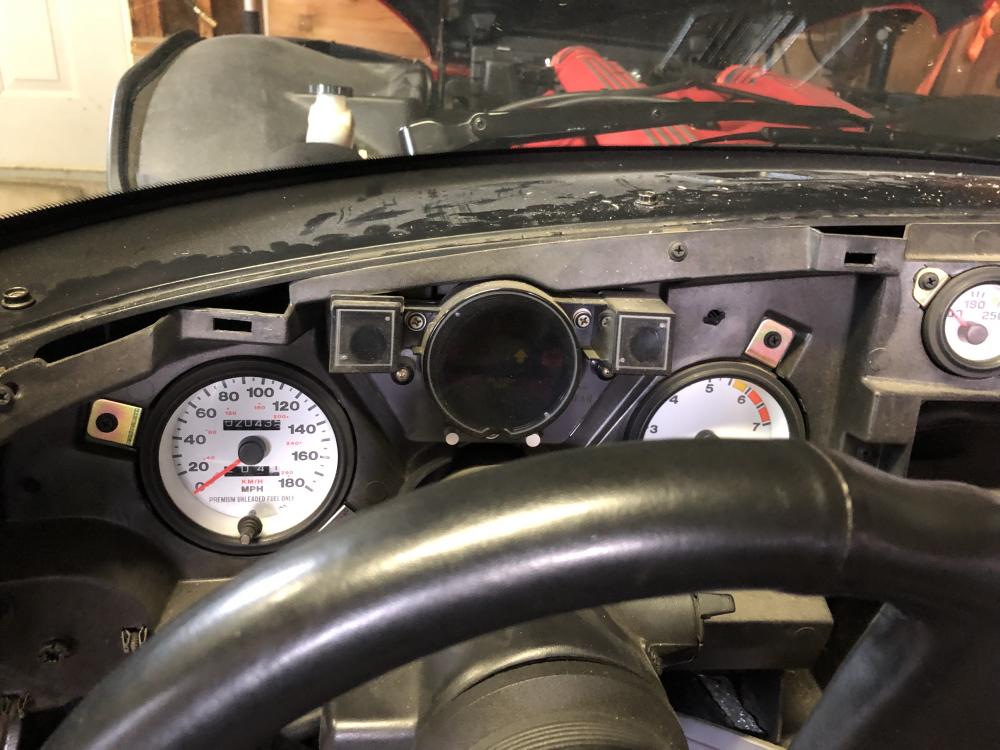

      4) Here comes the fun part. Once you have all the screws out, you will notice that the bottom of the upper instrument trim is pretty loose. But the top is still firmly in place. That is because there are 5 or 6 slotted attachment points along the top. The last dash trim I saw online was about $2k. So stop here if you have heart conditions.

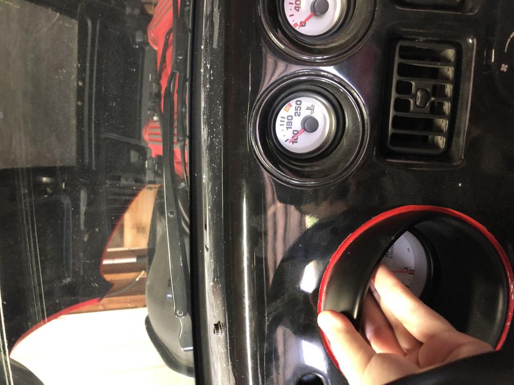

      Starting with the Speedometer, grab the “overhang” with both hands and firmly (but gently) rock it back and forth until it comes out. This felt like the strongest point and right above one of the clips. Do NOT start from the far left, as this is very weak. Go slow, this isn’t a race. This took a very long time and a lot of patience. Once you see the pictures of the back of the trim, you will get the idea. Eventually, it will pop. Then move over to the RPM overhang and pull on it. The scariest one for me was the one above the 4 center gauges and the one towards the glove box. These felt weaker to me, but at this point, half of the panel was off, so I think that helped. Once the whole thing is loose, I would recommend taping off the A pillars so you don’t scratch them when you remove it.

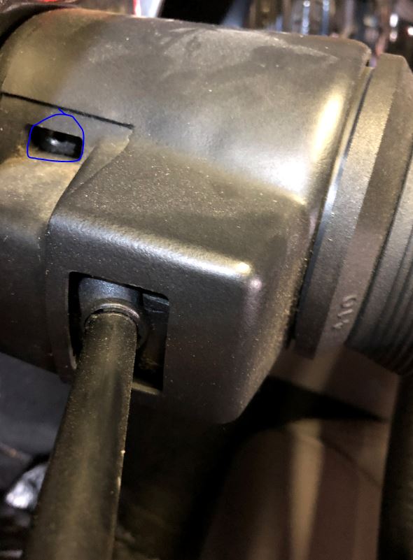

      At this point, you will need to tilt the steering wheel down to its lowest point. Then unscrew the til knob. No special tools needed, just unscrew it counter clockwise. Mine was only hand tight, so some might need to cover it with a towel and use some pliers.
      Now, last but not least, you need to remove the headlight pull switch. I noticed that the lights were left on when I pulled mine, that is why I had you pull those low beam fuses 🙂
      There is a small button on the backside of the knob that can be pushed in that allows you to pull the whole lever out. There is a great video on YouTube about this. Just search for RT/10 Dash Removal. Unfortunately he left out a lot of the smaller details I’m including here.

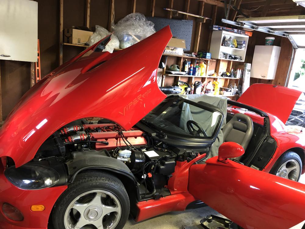

      1) The sight gauge for the radiator overflow is in the passenger wheel well on this model. It is a rubber grommet rather than the vertical slit in other years. NEVER take off the radiator cap unless you know what you are doing.

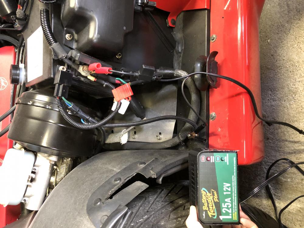

      2) The battery tender location is in the driver side engine compartment. Pictures to follow. Get a battery tender if you don’t have one. The current draw will have the batteries dead in about 2-3 weeks.
