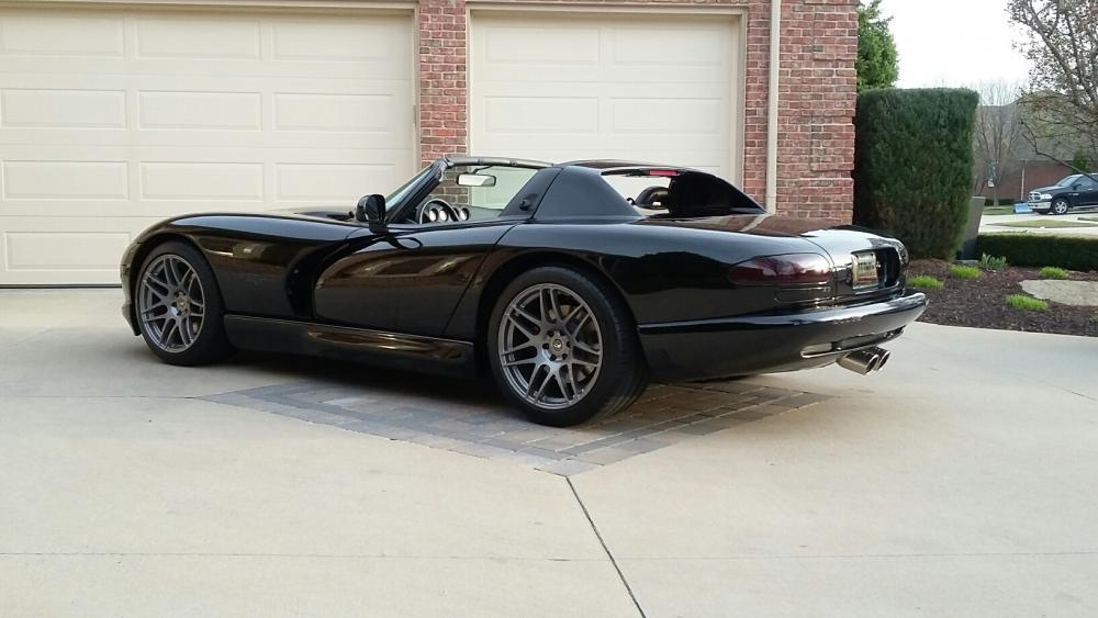

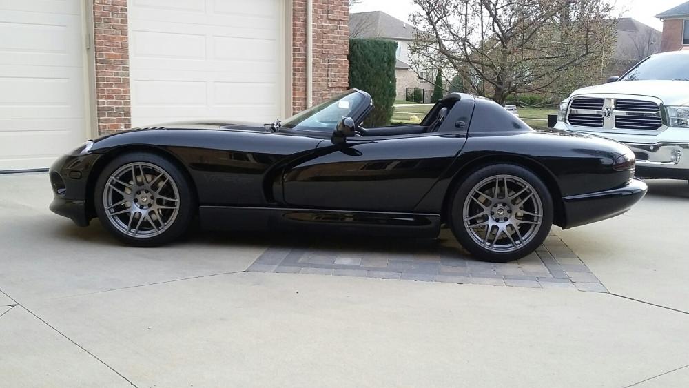

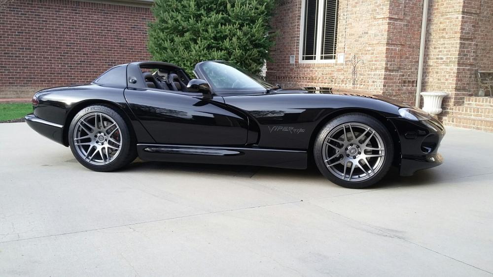

      Forgestar F14’s in gunmetal color from Tony at DV8 Motoring. 19×11 fronts with 295/35/19 Michelin Super Sports & 19×13 rears with 345/30/19 Michelin Super Sports. After doing my research I went with a 35 series in the front so the front and rear tires are equal height. Doing the 19’s along with these tire sizes accomplished the following. The front fender gap narrowed by 3/4″, the rear fender gap narrowed by 1/2″. I also added the 1/2″ lowering spring caps which gave me an additional honest 1/2″ less front and back on the fender gap. With these mods the front facia has about 3/8″ more ground clearance from stock which really helps with Michigan roads. IMG_0092-4.jpgIMG_0110-3.jpgIMG_0109-1.jpg
