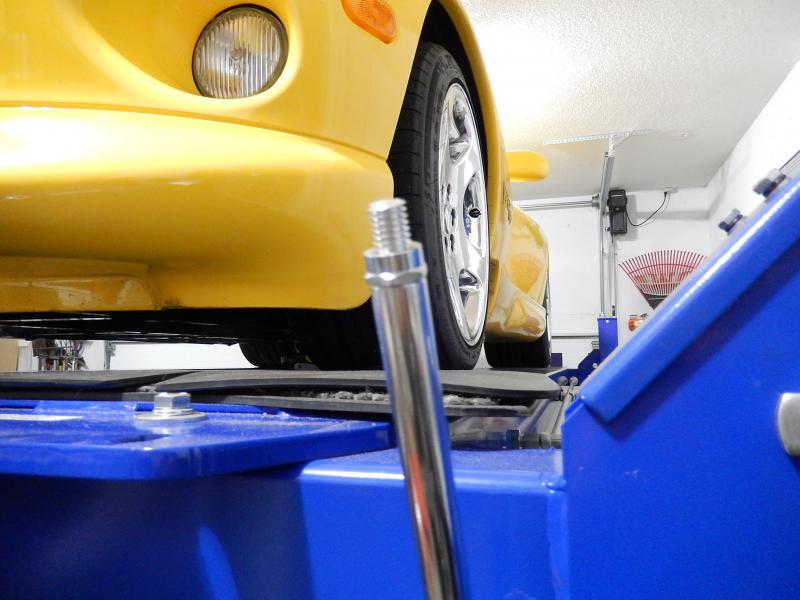

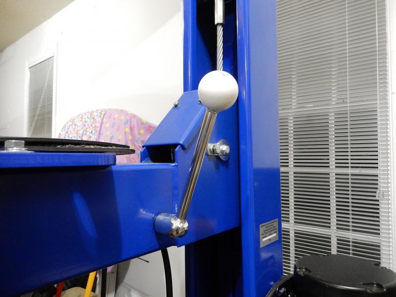

I’ve been enjoying my Quality brand four-post lift for over a year now, and since the warranty period is complete it was time to make a minor modification to the lift. The original lever to release the mechanical locks was a straight rod, and not very comfortable to use. A shift knob would make it much easier to use, and look pretty cool as well.
Here’s how the lever looks now:

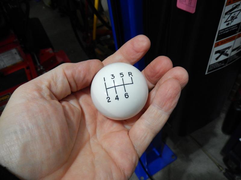

The knob is a Hurst product that I ordered from JEGS (arrived in 2 days!):
It’s about as basic as you can get, and has a classic look to it:

Overall, it’s an easy modification and is much more comfortable to use than the plain old lever.
