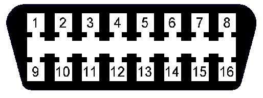

2. (1996 ~ 1998 GEN II) Ground pin C13 loose green wire taped to harness of EEM connector, which is under dash mounted on the left side of trans tunnel, directly above accelerator. Easy access if you remove knee bolster and rubber bungee cord that holds EEM to tunnel.*2A. (1999 ~ 2002) As #2, but instead of C13 you’re grounding Terminal 1 of the DLC, Data Link Connector, i.e. the under dash OBD2 connector which is above your left knee2B. (ALL GEN I) Ground green “Program” Wire located next to SAM and RKE modules. Is a green wire with a bullet connector on end. Is located under driver’s side instrument panel.Hint, Make sure you’re connecting to a solid body ground by testing it with an ohm meter.
