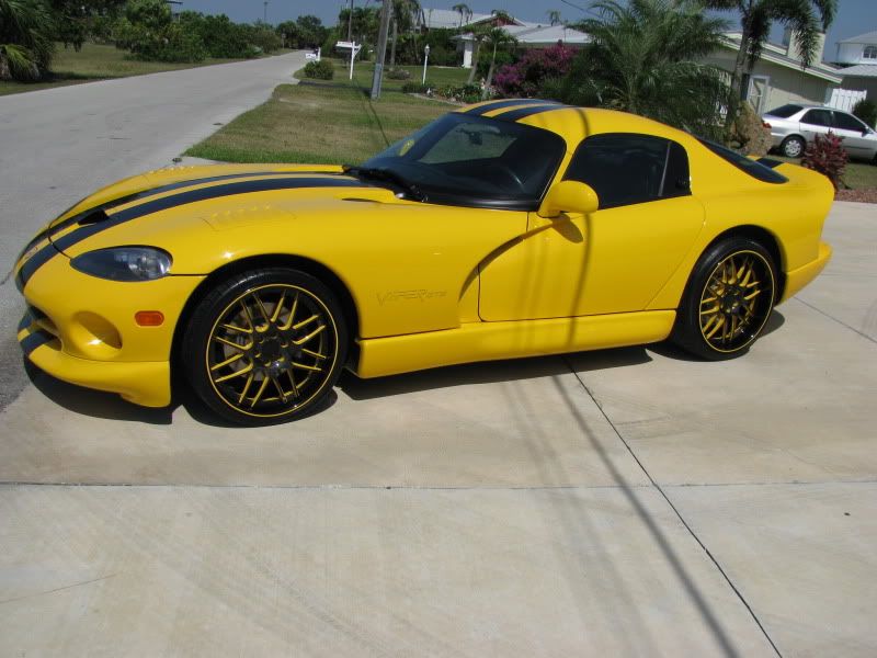

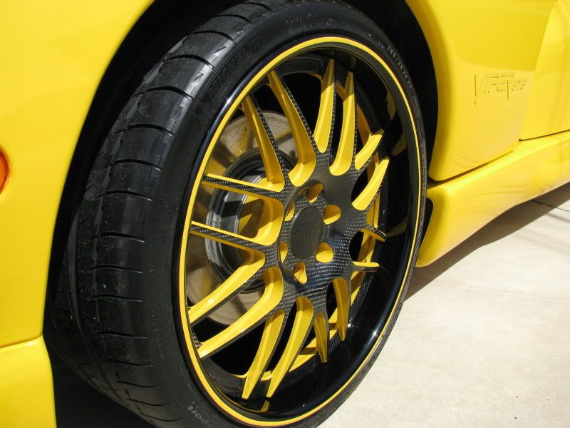

They will bolt on but the front off set is different on the gen V. Your aftermarket wheels may set inside the wheel wells a bit further then you like.
All in all they should fit without any issues. Always do a test fit. You’ll have to deal with the foolish tpms light on.
