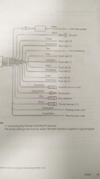

      Wiring for the Clarion stereo (from the guide) –
      Connect the GROUND wire first
      *ATTENTION* Instead of wiring the Blue from the Viper to the Blue for Clarion, connect the Blue wire from the Viper to the While/Blue (remote amp turn-on) for the Clarion. If you don’t do this, the AUX, BT Audio, USB Audio will not work.
      Next, connect the speaker wires between both harnesses. Leave the POWER and 12v ACCESSORY wire for last.
      Once done with connections – .
      1. NO loose wires should be left from the Viper harness (you would’ve found the corresponding wires on the Clarion harness).
      2. The following wires from the Clarion harness will be left unconnected – Blue, Parking Brake cord, Reverse gear cord.
      Quick note about the Clarion – the other huge bunch of wires fixed to the unit will be a PITA to fit in Viper’s dashboard so I decided to cut all of them except Sirius, Rear Camera, HD Radio and Ipod. That made the head unit slide in easier, and it still works perfectly.
      *DISCLAIMER* Cut these wires at your own risk because this WILL void your Clarion warranty. If you can fit them all in the dash, good for you!
      *ATTENTION* Don’t forget the electrical tape ! Make sure NO wires are left exposed, it’s only a matter of time until one of them shorts something out.

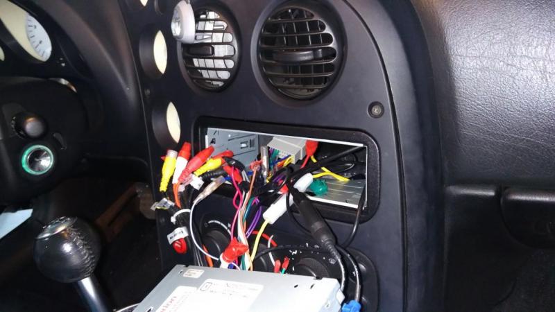

      For this next part, I suggest covering the center console with a cloth and setting the Clarion stereo on top. Makes it easier to work and prevent scratching.

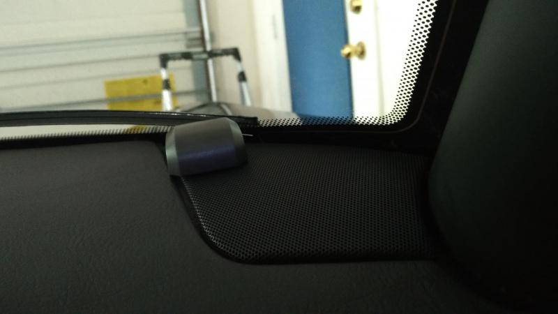

      GPS antenna – I followed the placement guide in the Clarion install guide, and putting the GPS antenna above the passenger side dash tweeter is the best signal I got (accurate location with the garage closed, even my Garmin can’t do that). It also has a magnet underneath so it can stick on the tweeter without having to stick anything to the dashboard.

      STEP 6 – Slide it in (That’s what she said !! Sorry, I couldn’t help myself.) – Slide the Clarion in slowly, keeping the *fixed* bunch of wires (ziptied) to the left (there is a hole there that can hold these), and the rest of the harness in the middle-right, antenna wires to the right.
      Slide in slowly, and use a long screwdriver or stick to gently push wires to their places. The last 1 inch or so will feel like you’re pushing too much, but it’s okay, just push gently till you hear a click. Put on the Clarion faceplate and you’re all set.
