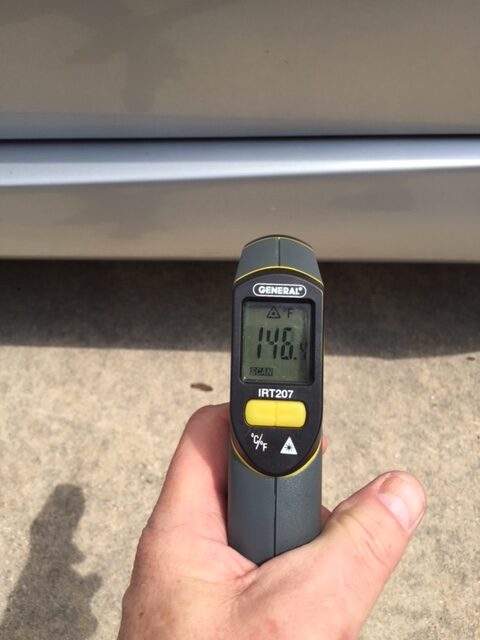

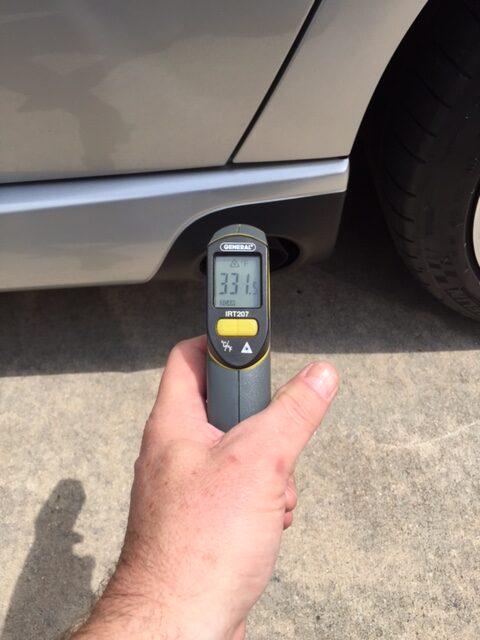

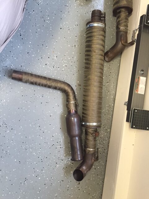

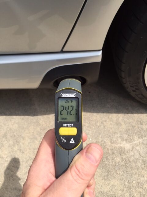

      Today I took my stock Gen III for a 45-60 minute ride and measured the surface temperature of the rocker panel, and the black area of the exhaust port. The weather outside was partly cloudy with the temperature of 79 degrees, the exterior car (door panel) temperature was 91 degrees, With the engine running the rocker panel was 146 degrees, Black Exhaust Port Panel was 331 degrees. Both sides of the vehicle were with 3-4 degrees of each other. I obtained some Gen IV Cats and Mufflers (Thanks to Tom Sessions) and wrapped them with DEI Titanium Exhaust Wrap – temps good up to 1800 degrees. I took the following temps/pic with engine running and then took them again after the engine was off for five minutes.
      This pic temp at exhaust port w/engine running at idle.
      This pic temp of rocker panel w/engine running at idle
      This pic temp at exhaust port w/engine off for 5 minutes
      Pic of Gen IV exhaust system w/wrap
      Not knowing how accurate this handheld device is, but gauging it to my wife’s “O ShxT” yells when she forgets to exit the “right’ way, I would say its pretty close.
