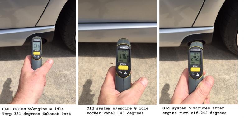

To recap part one here are the temps with OEM exhaust.

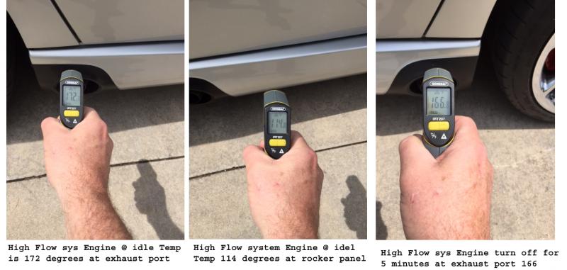

Here’s the temps with the high flow exhaust:

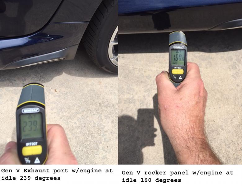

Here’s the temps of the Gen V at idle:
The readings at the exhaust area were not done at the tailpipe, but rather an inch or so above the top of the tailpipe. Tom Sessions said I did not need the exhaust wrap, but since I already purchased it and didn’t want the hassle of returning I used it.
