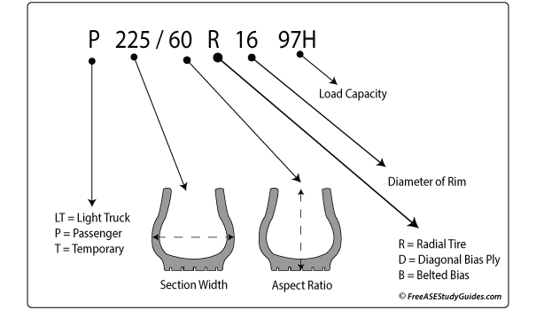

      I think that it is standardized; however, they do not measure the tires in a normal usage condition. They measure them without load and at maximum rated pressure which has no correlation to actual usage. I expect that the construction characteristics of the tire, such as sidewall stiffness and rubber hardness substantially affect the actual width in usage and would be different between manufacturers, and also different between different tire types of the same manufacturer. (The width will also be different from the specification when inflated to normal pressures, loaded with the actual car’s weight, and mounted on whatever width wheel is being used on the car if different than the width wheel specified for the measurement standard.)
      The confusion is the tire specification does not state tread width, it states section width. The widest point on the sidewall.
