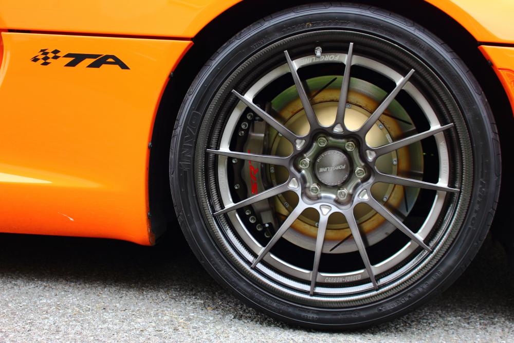

      Recently installed this setup on my TA. Purchased through Andy Wheeler at Viper Exchange. Brake components manufactured by StopTech.
      The kit comes with rotors, calipers, mounting hardware & brackets, pads, and SS lines.
      Rear rotors stay the same setup (mostly). 355mm disc and four-piston calipers. Fronts increase disc diameter from 355mm to 380mm and calipers from four-piston to six-piston.
      The fronts do fit inside a Sidewinder II, but there is literally 1mm of clearance between the caliper and the wheel. In fact, the FR wheel was scored a little bit by one of the caliper cross bolts on mine, so 0mm clearance. Prepare for rocks and rubber to get caught in that gap on the track.

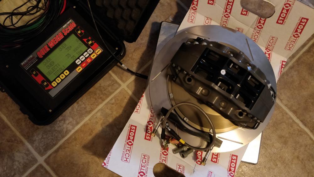

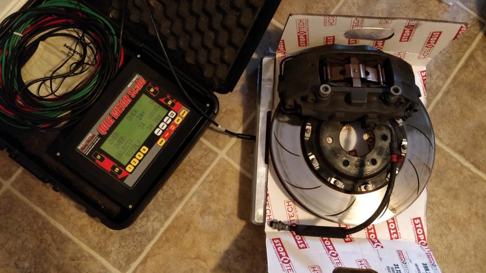

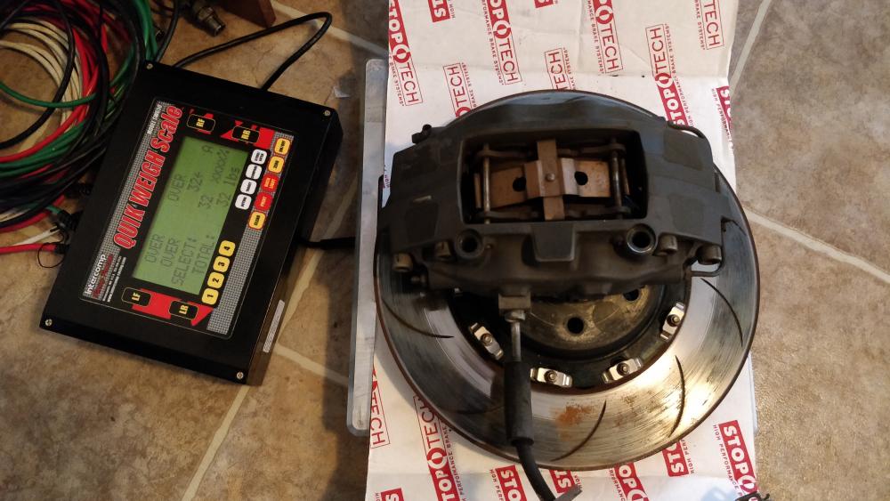

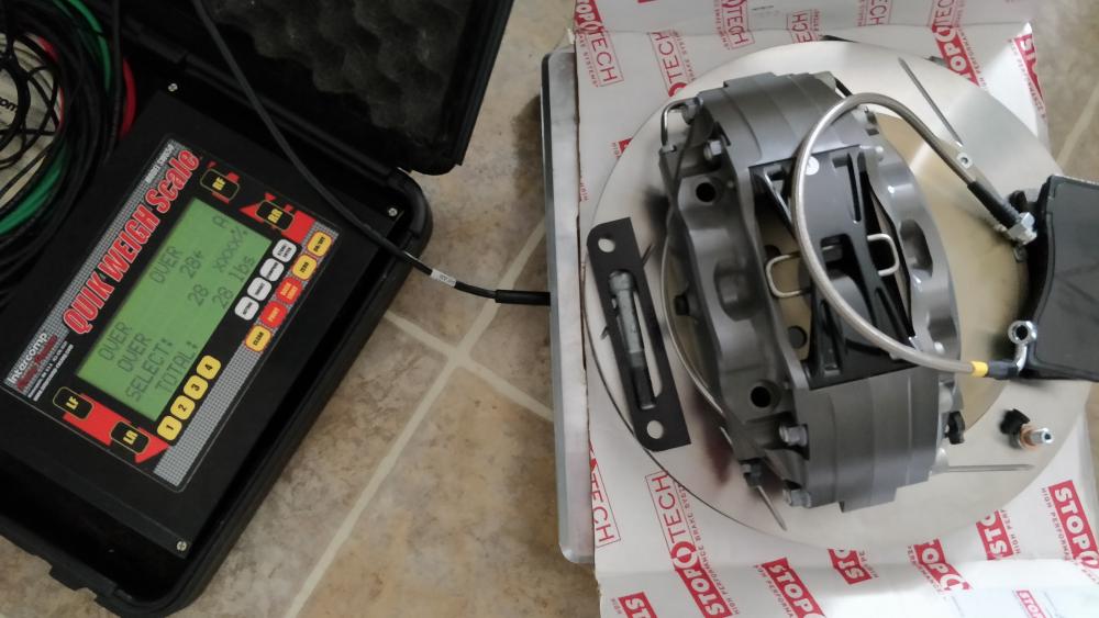

      Here’s the weights, per corner:
      OE Front Setup – 32 pounds (forgot the mounting bolts in the photo, so maybe a few grams more)
      VE Front Setup – 35 pounds
      OE Rear Setup – 34 pounds
      VE Rear Setup – 28 pounds
      So there’s a tidy six total pounds lost. Woo hoo! The brake pads were included in the weighing. The OE pads I removed were all at least 12mm thick, so I don’t consider there much offset there. The kit installed relatively painlessly, and could easily be done in a day.
