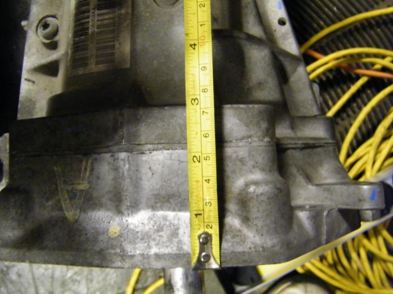

      It’s not just the length of the shaft. Since the clutch pack is thicker, the adapter plate (adapts tranny to bell housing) on the front of the transmission is deeper to accommodate the extra.T56-adapter.jpgT6060-adapter.jpg
