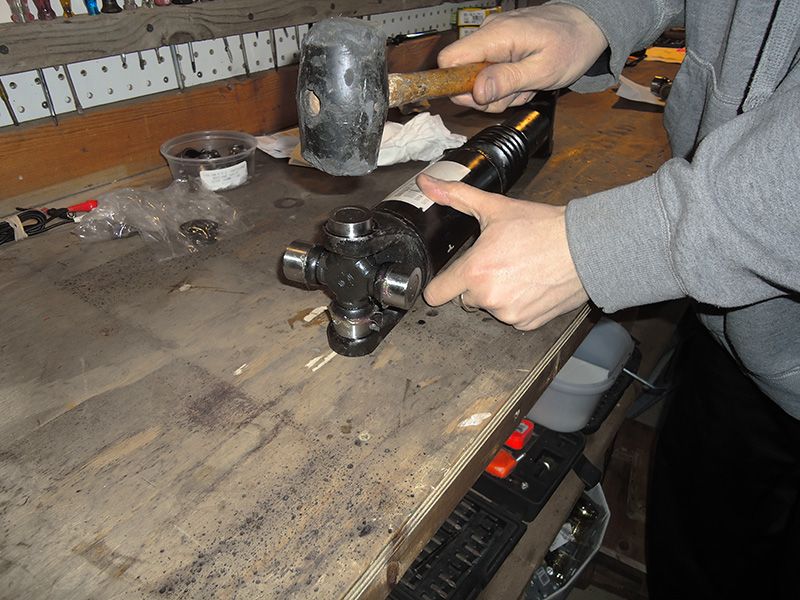

Now we get to the removal of the u-joints. Hammer (using a metal cylinder on the cap) or press out the old u-joints.
Clean the holes thoroughly, so that the new caps will go in smoothly. Grease all caps properly before installation, making sure not to lose any of the metal needles. You will have to remove one or both caps (depending on which end of the half shaft) in order to install the new u-joints. If you’ve never replaced a u-joint, it might be a good idea to read up on some of the finer points, but it’s fairly straight forward. Gently knock the removed cap into place, so that it can now be pressed into the socket.
A vise will be perfect for this. I used a socket that was about the same size as the cap to get an even pressure application. The cap should go in smoothly.
Push it in just to the point so that you can insert the clip.
Repeat on the other side of the u-joint. Once both clips are in place, you will have to release the tension, as the u-joint will likely not move freely. Again, you can use the vise for this. Place the two free caps over the vise opening and gently tap the yoke until the u-joints move freely. It’s all much simpler than it sounds.
Repeat above steps for all four u-joints.

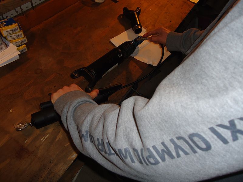

Next up is regreasing the slip yoke (note: I actually completed the slip yokes before replacing the u-joints, as you will notice in the pics). Make sure to mark the two ends with a marker. Half shafts are balanced, and you don’t want to put them back together in a different orientation.
It’s enough to remove one of the metal clamps (one closer to the splines in the yoke). Pull apart half shaft, and inspect for damage. Check quantity of grease remaining.
Remember not to completely fill the cavity with grease, as this will cause hydrolock when the halfshafts compress. Just enough to cover all the splines and have a reservoir of grease. It’s a good idea to measure maximum compression to figure out how much to put in. I noticed that mine where quite low on grease and definitely needed some extra.
Carefully reinstall both end of the shaft, paying careful attention to the markings made earlier. Fasten rubber boot with zip tie, making sure it is well sealed.

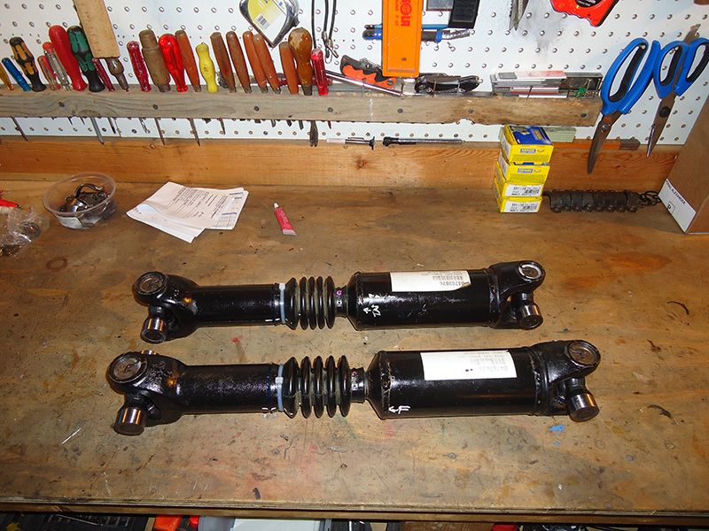

Reinstalling half shafts is the exact opposite of the removal process. It might be a good idea to secure the caps when sliding them through the shock fork, to prevent them from coming off (just tape them on).
I used new straps (even if the old ones look ok, they might be slightly warped), but reused the original metric bolts. Use locktite on the bolts. The bolts are torqued to 36 Nm. Again, you will have to rotate the shafts in order to get to all of them. I used some socket extensions for a few of them, as space around the u-joints can be tight. Also, I had to put the handbrake on when tightening the bolts, otherwise the shafts will rotate and not allow proper torqueing.
And that’s pretty much it. Let the locktite dry overnight. Do not retorque the bolts, as this will break the locktite. Overall, this is an easy and inexpensive rebuild. Cost is around $100 for all parts, time is about 3-4 hours for the entire procedure.I take no responsibility for the steps in this write up. Attempt at your own risk, and feel free to modify and change any of the above points.
