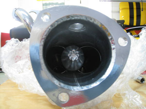

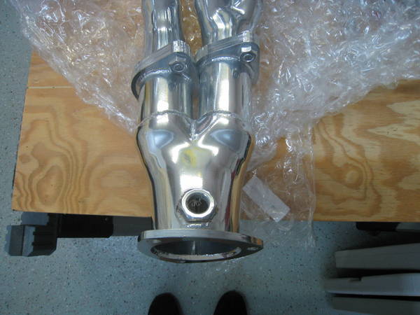

      I have Belangers which are similar to M&M’s so take my experience in that context. I welded in O2 bungs at the collector area. My OEM O2’s threw the heater codes a few times. I then tried Walker O2 Sensors (heated) and no codes. Then, I did my mods about 2 years ago and replaced my O2’s. I’m now back to using the Mopar O2’s. No codes. Lou welded in the O2 bung on top of the collector. I also use a smaller pickle in the collector. I don’t know if this helps or confuses you, sorry!

      Tony can you post a picture of your heat shield where the o2 goes through? I don’t have a pickle in mine, i wonder if I should mount the o2 on an angle towards the engine. Do you have cats and does your car run rich or normal during regular operation?

      I have the same set up as ViperTony although my bung is placed about an inch or so back. I use OEM o2 sensors, stock heat shields, and no CEL issues. My car doesn’t run rich with high flow cats.

      I’ll take a pic tonight but I ended up drilling a hole through the heat shield to allow the O2 sensor to fit. I’ve seen some put the O2 bung as you stated at an angle towards the engine and event to the side of the collector to clear the heat shield. Yes, I have HF cats. During closed loop it runs normally.
