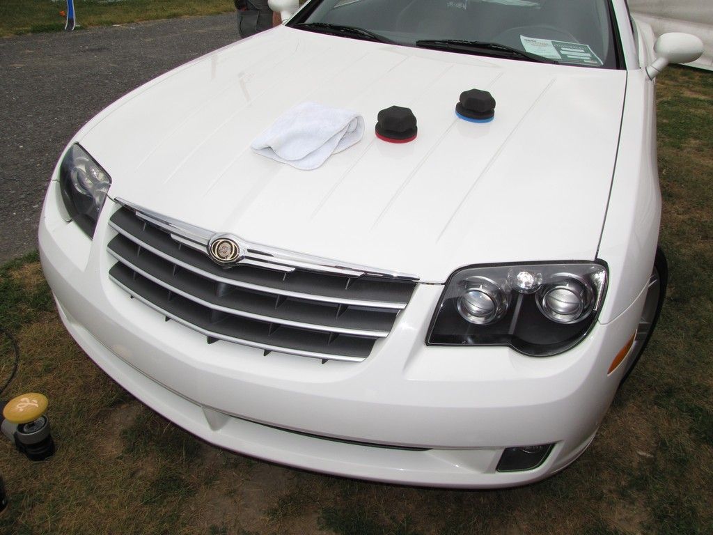

      You can do it with your regular compounds and polishes, along with your orbital polisher. No need to go out and buy anything fancy unless your lights are really jacked up. Then you would need a stronger polisher. If you are going to do this, I suggest you invest in some smaller 4″ pads like what I use in my debaging video. Chemical Guy’s sell them.
      [video=youtube;rESYPF3PI3Y]http://www.youtube.com/watch?v=rESYPF3PI3Y[/video]
      Thanks Junkman!!!!! I should have known you had a video on it. I will try my regular stuff first. They aren’t bad just some regular washing type scratches.
      Any decent polisher should work, with the right polishes.
      I use a Dewalt drill with a Cordless Drill Backing Plate, Adam’s 4″ Pad and, depending on how severe the lights are, Adam’s Correcting or Finishing Polish.

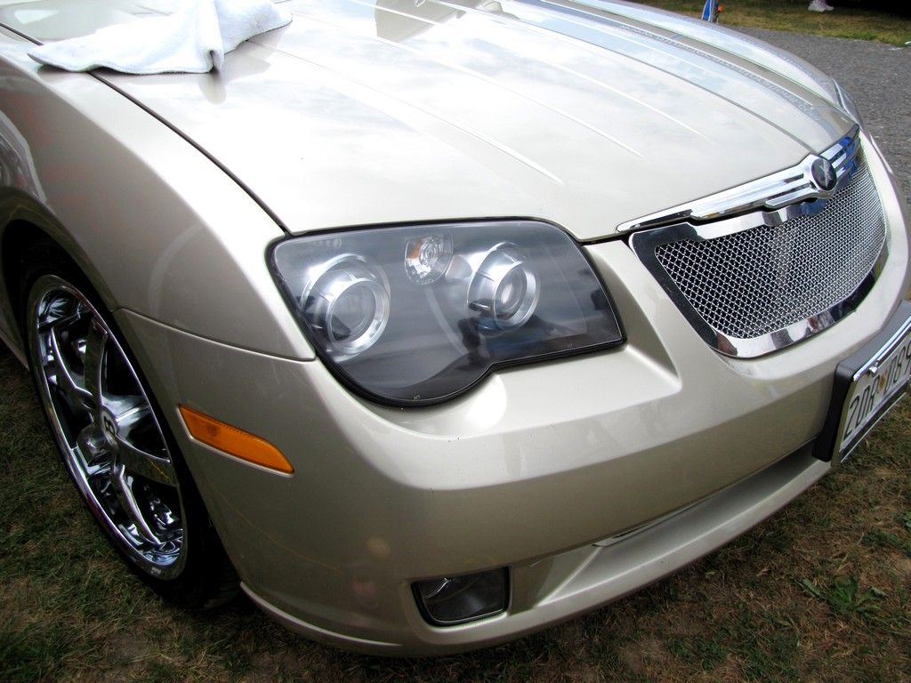

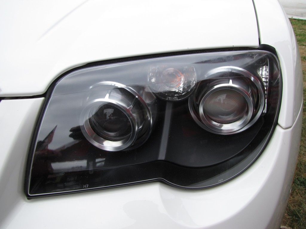

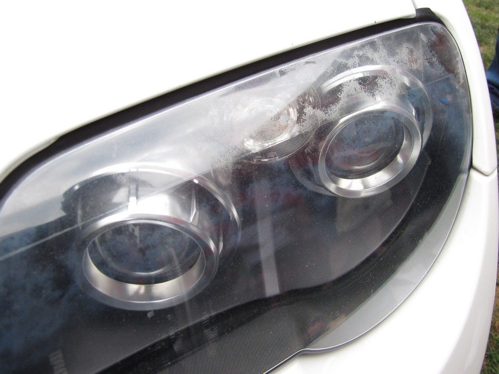

      Here are some headlights that I did with a compound, followed by a polish. I used the same setup that you see in the video that I posted earlier. Nothing fancy, just took my time and polished away. One thing that you have to be EXTREMELY careful about is the headlights on some cars are made of plastic and you can actually melt them if you use a drill at too high of a speed (you can also burn the paint around the headlights too). A drill is just like using a rotary and we all know what a rotary can do to paint.
      BEFORE:
      AFTER:
      BEFORE:
      AFTER:
