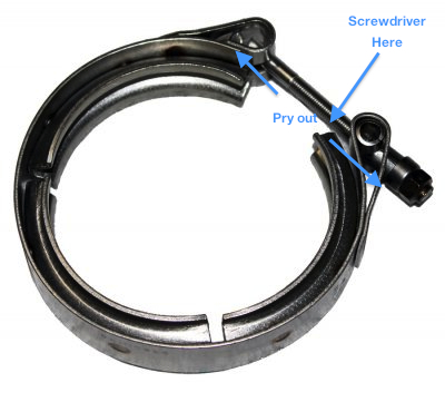

    • SlateEd
      Post count: 1087
      the 11 millimeter head on the bolt needs to be loose in order to get the clamp off. It’s hard to get at – I went with a deep well socket and long extension but I may have been lucky that the bolts were pointed downward.
      once you get the bolt loose, the clamp may not loosen itself up, so then helps to get a long flat head screwdriver in from the side behind the bolt and pry to get the clamp to let go.
      hard to explain in words.. maybe photo of the clamp will help:
