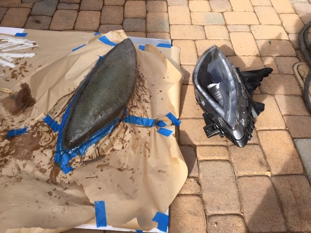

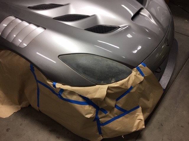

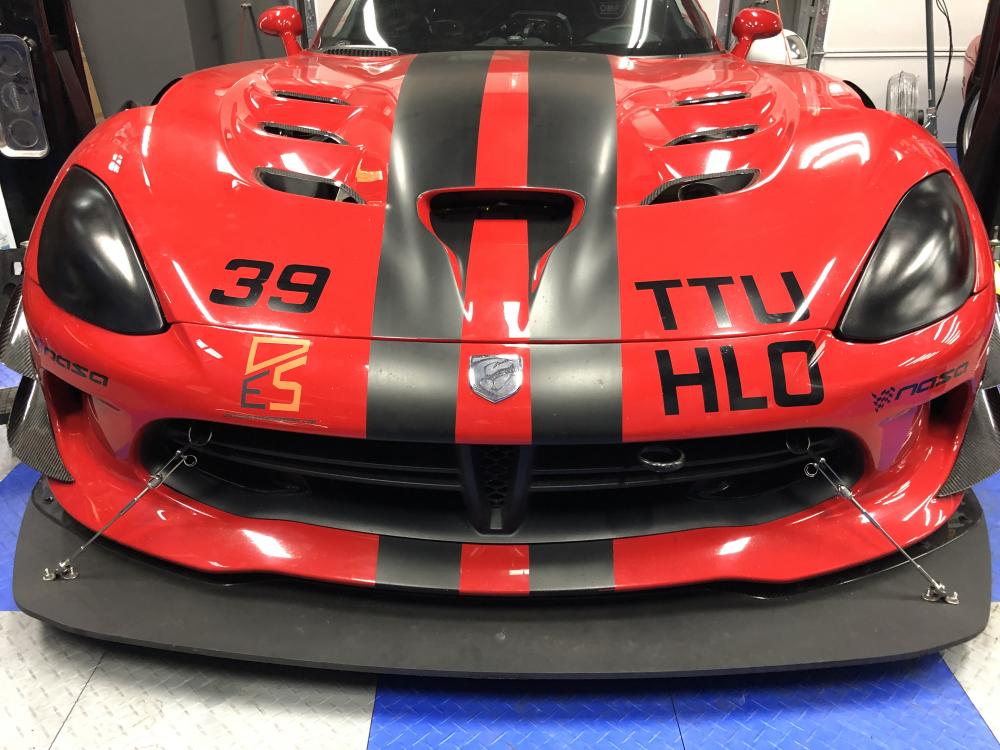

      Carl,
      I pulled molds off of my Gen V ACR without damaging them. Then I built carbon fiber blanks for Cable’s Gen V. Saved a lot of weight! With good mold release wax and PCA water-based parting agent you can avoid damaging the original parts. It’s just a little time consuming.

      Cable said 11.5 lbs, and I think that was per side.

      Yeah it was 22 lbs off the nose. Thanks again Pappy!!!!
