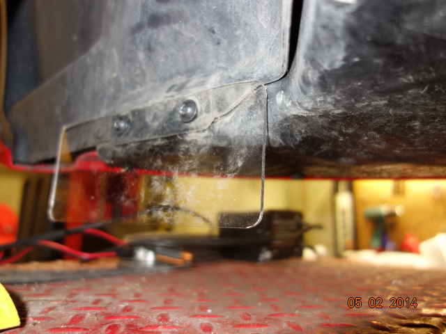

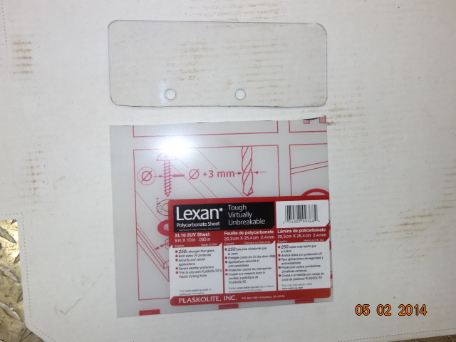

This might be old news, but, I have been trying to find some material to replace one of the wind deflectors (rectangular plastic piece in front of the front tires). The problem is, the material has to be rigid, flexible and durable, all which seem to be contradictions. I think I found the perfect product, the cost was $4.00 and I can make three deflectors. It is packaged Lexan that is 8 X 10, I bought it at Lowes in the hardware section next to the sheet plexiglass.
Here are the pictures of the packaging and the installed deflector.
