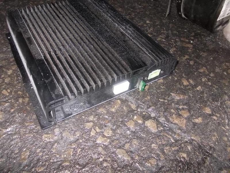

The place that installed it is out of business now……Is there a connection on the amp that you can get to and unplug? Looks like that’s the only way to tell if it’s working or not…..Have good volume on stereo but that might be just the stereo??

Well there’s 2 ways. There’s a fuse you can pull on the amp it’s self, or you can pull the connections for the amp to the head unit. Unbolt the amp and you’ll gain access to them, then just pull the fuse or pull the connectors and you’ll have your answer.
Thanks again….Your another reason that makes this forum so great…Hope you didn’t take your amp out to take that pic for me 🙂
