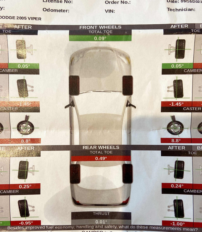

      My alignement at the moment.
      Correction: it’s not 0,05 front wheel toe-in but 0,05 toe OUT as you can see. Neutral (zero toe) or very slight toe-in probably works well too. That tiny toe-out helps to get a better more responsive turn in, especially with such high 8.8 caster.
      Probably can be tweaked further more.. maybe more/less rear camber… maybe a little less rear toe-in… But I’m very satisfied as it is right now. Not even sure I’d want much higher camber for the track, at the cost of reducing the caster… On a small technical track, yes, probably. But a track with high speed turns? Nope.
    • 13COBRA
      Post count: 3741
      You definitely want negative toe in the front and a little positive in the rear.
    • Aevus
      Post count: 914
      I tried everything from (Front and total) +0,10 to -0.38 deg and it seems to work better around neutral (in or out, 0,10 deg maximum) and quite a lot of rear toe-in (0,40-0,50 total)
      On the other hand, I was fighting the bump steer issue (see other thread: TKO bump steer correction kit) and I had that kit installed when I did my last alignment.
      The TKO kit clearly is THE solution to the bad behavior of the car at 50-60mph+, but the alignment is felt at any speed.
      Not sure I’d want to go back to slight toe-in since I don’t feel any drawback from that slight toe-out. In fact, I’d be curious to try more toe-out, just to see if it would feel more responsive (without being unstable)

      On the front of the car, toe out decreases straight line stability. When a wheel is disturbed in a straight line with toe out, pulling the wheel rearward of the steering axis, it increases the toe out and effectively turns the inside wheel more outward, pulling the car into yaw. This decreases straight line stability as it makes the car develop a twitchy nature which can be uncomfortable at high speeds.
      However, running toe out makes for faster turn in on the front end.
      https://suspensionsecrets.co.uk/toe/
      Oh, I just noticed that the base set-ups recommended on Suspension secrets is exactly that: toe-out front and toe-in rear.
      https://suspensionsecrets.co.uk/btcc-touring-cars/
      (for the rear wheel drive configuration)
      They recommend 0-4mm total, which translates to roughly 0.16 in. or 0.35 degree.
      I probably wouldnt dare going as far as 0.35 deg total toe out on the front but maybe 0.20-0.25.

      Negative toe is toe-in.

      Toe in works better in front since the viper is a heavy front engine car and has a problem with excessive tire wear especially gen 5 . The toe out rule was based off rear engine light weight cars and it does work for sure. When it comes to front heavy front engine cars or cars with other problems sometimes you throw out the book and find what works best.
