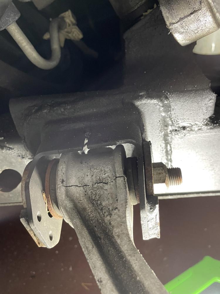

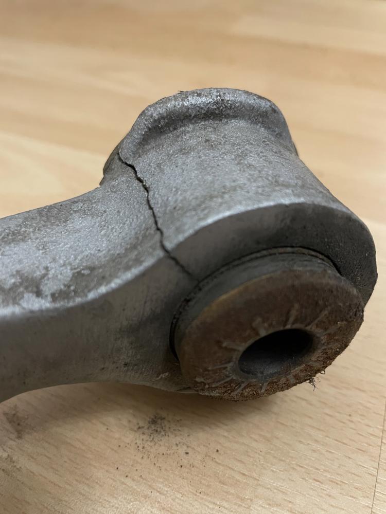

      I also had 3 cracked suspension arms which I replaced last year, although this issue is only common in europe due to the salt used on our roads (apparently)

      sonicbloo has offered some excellent advice.
      Just to be clear, many U.S. states use salt on the roads. His point about inspection of the control arms is a very good one.
