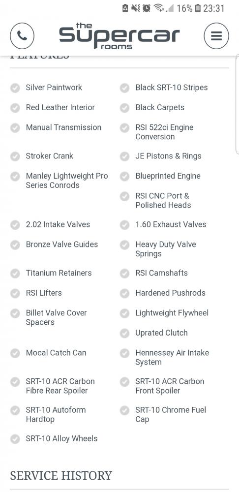

      Have put the specs of the car below.
      Performance wise just something else, it’s fairly lumpy in first and second or even 3rd when you are bumbling along aat a constant speed and that all clears nicely when accelerating. Just wondering if it’s a much more aggressive cam profile and that’s life or whether a revised map will smooth things out.
      I’ve had previous performance cars (some very silly bhp) with motec and link ecu’s with multiple maps loaded etc but dont really want to go to silly expense putting one on the car if there is a simple reflash.
      The mods were done from new with the previous owner and performed by RSI under a 750 package. Technical specs of cams etc not listed.
      Spec below
