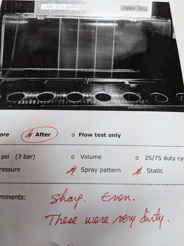

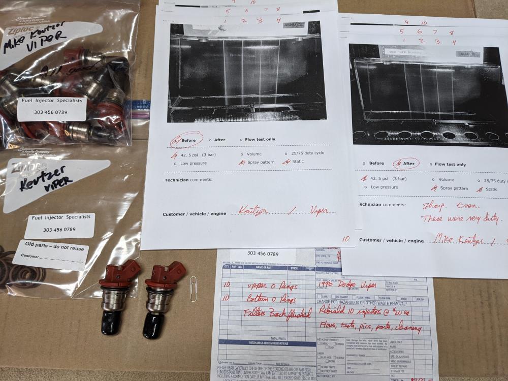

      Packet coming back from service. Contents included the serviced injectors, old O-Rings, printed before/after results for each injector. I labeled my injectors before sending out, they stenciled each injector number as well.
      Before/after results with pics and comments:
