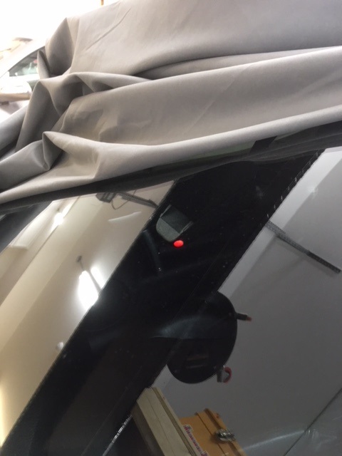

      I took some spray paint and masked a small circle on each side of the lens. Painted the entire lens, removed the circle.
      Now when the alarm is activated a small red dot appears on both sides.
