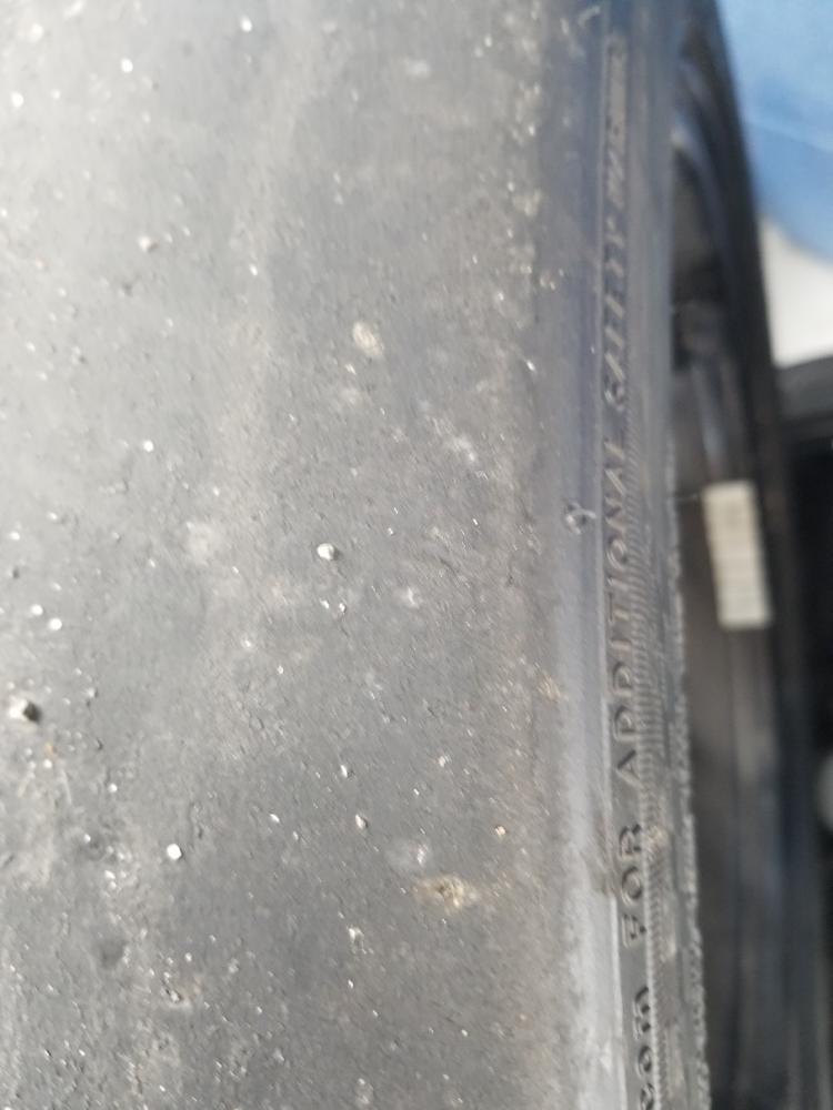

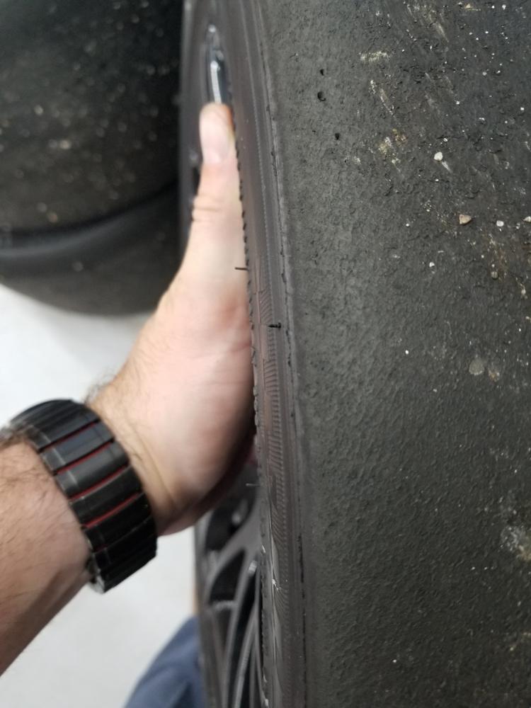

      I did. They are hotter on the outside, but only by 8-10 degrees.
      Add more camber then. You’re only going to get maybe -3 deg max out of the stock suspension.
      Below are the inside and outside of my front tire. I rotate side to side during the weekend so they get equal wear.
      The outside of the tire is used all the way to the sidewall, but the inside has a fairly noticeable strip still. Do I need to go more negative, or leave as is?
      As far as feel goes, it handled great all weekend; just wanting to maximize rubber on asphalt. Running Hoosier R7s. I run -2.5 now, in my Gen IV ACR.
      Outside:
      Inside:
