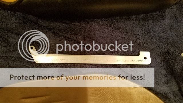

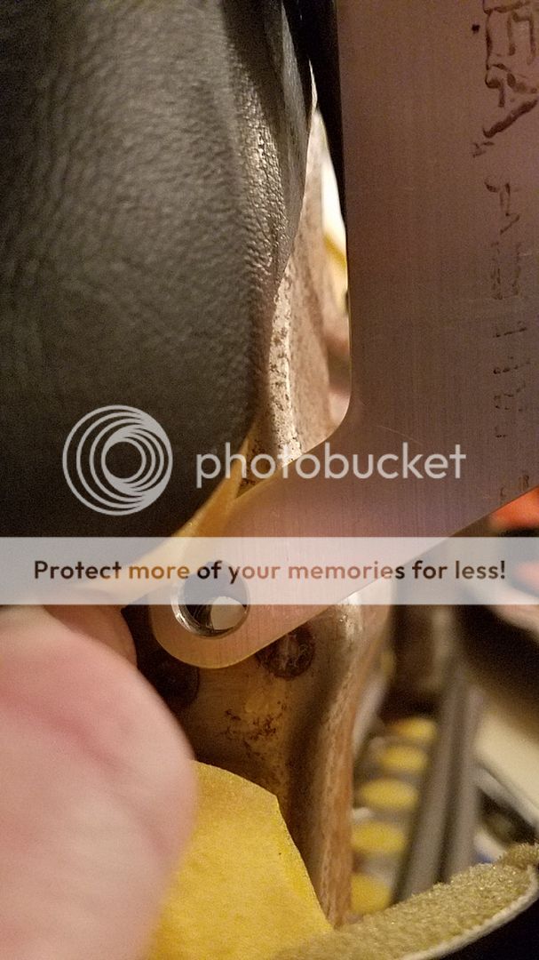

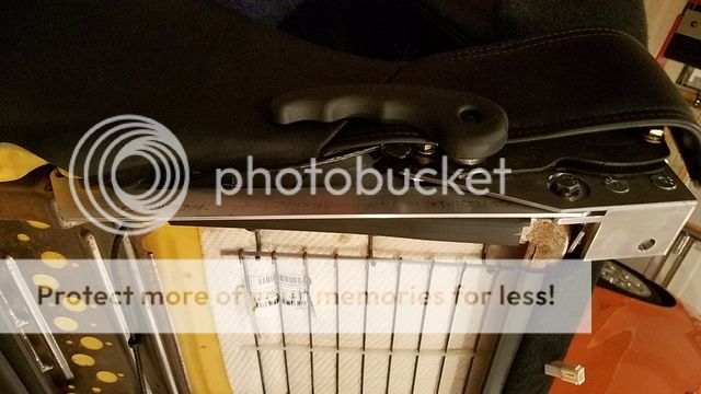

      Anywho, here’s where I’m at. I have attached each of the rear brackets. I have also fit each of the front brackets. Now I have the long extra piece that is supposed to prevent the bottom cushion from sliding forward when the seat back angle is adjusted. From the looks of the outboard rear seat bracket, there is a slot where it fits in, and this is where the extra bolt was that came with the kit. It appears as though it should connect to that rear bracket and then run towards the front of the seat and mount with the same bolt as the outboard front bracket. However, the gap between the two mounting holes of the long piece are a quarter inch too short for me to be able to do that. I’ve looked around it do not see anywhere else where this piece should go based on the length and the description in the instructions.
      So does anyone have pictures of where it should go?
      Here is the piece in question:
      This is how I was trying to mount it:
      And a picture showing the quarter inch offset:
