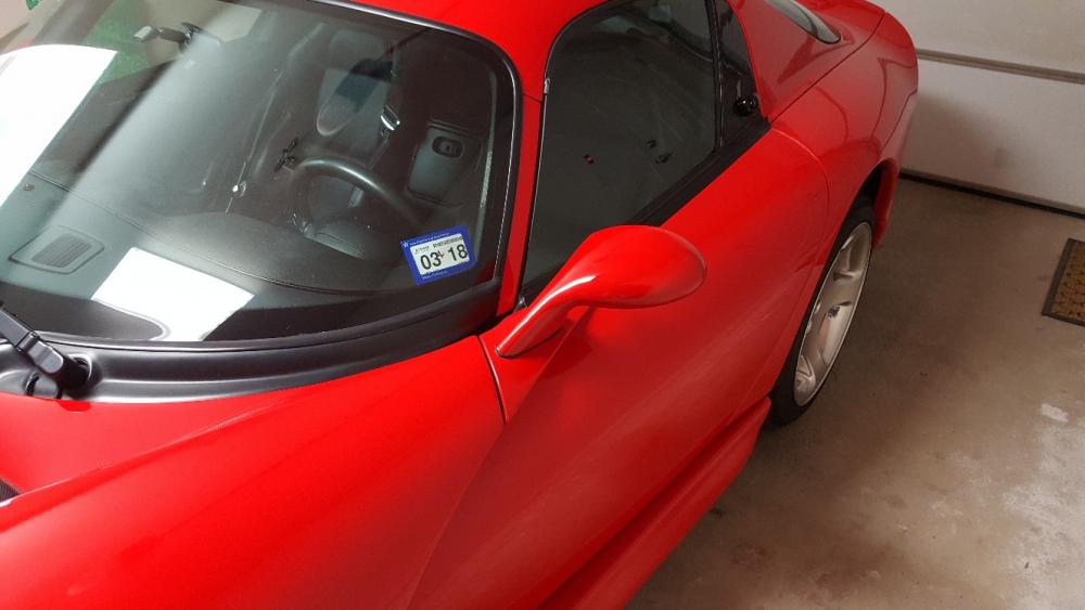

Here is the Borla 16″ Race XR1 Mufflers for the side pipe conversion they just showed up! also i attached the pics of the Plymouth Prowler Mirror conversion i just installed last week. it took like 3months to find all the mirror parts all brand new and genuine.20171027_132829_resized.jpg 20171210_203032.jpg

Prowler mirror conversion cost about 700.00 with paint motors and glass including harnesses i also rewired the mirrors so i could use the factor viper mirror switch in car. its just the same as the prowler set up just diff. wire colors for left right and up and down.

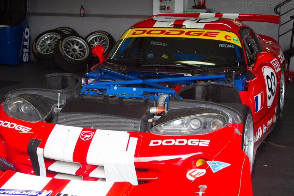

I thought long and hard about exactly that, how far are you going to take this Adam…………self balls out man you only live once! yea i thought about giving more money to autoform steve but…..i got other stuff to buy at this moment…..including locating or building a carbon fiber air box or a custom one that replicates the intake through the front splitter/ bumper because im getting rid of the NACA duct. Dodge-Viper-GTS-R-66380.jpg I’ve seen pics of those cars! i like them! do you guys have full cages in them?
