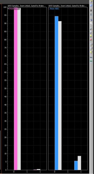

      As you can see in the snapshot (typical of many laps’ worth of data we reviewed), we can exert higher braking force on the rotors/tires, and, thus, achieve higher deceleration forces. As a result, we started to use later braking points in corners where significant braking was required (by 20 to 40 ft., on average), without loss of car’s balance. Not having rear ABS interfere on initial brake application was a critical part of being able to maintain the balance, and to build up optimal tire slip angle.
      Looking a little deeper into the data from the whole weekend, we can also see that there’s a reduction to rear ABS interfering (by about 30%), even though overall force applied to tires on deceleration, is greater.
      Even the front ABS engagement is slightly reduced (unexpected result), likely resulting from an overall improved balance of the car under hard braking.
