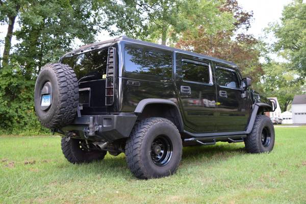

      I've always wanted one and so it's here. Paid a very fair price, lower than most would expect..it's going to look even better pulling the GTS when I need to. So long to my 1998 Yukon with 200+k miles..you were a good truck but time for a change. 00101_kcpst6AirUu_600x450-1.jpg
      That is a killer H2! How many miles on it?

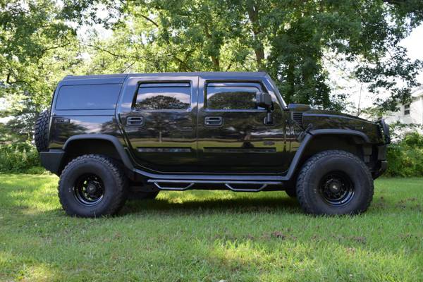

      I’ve always wanted one and so it’s here. Paid a very fair price, lower than most would expect..it’s going to look even better pulling the GTS when I need to. So long to my 1998 Yukon with 200+k miles..you were a good truck but time for a change. 00101_kcpst6AirUu_600x450.jpg
