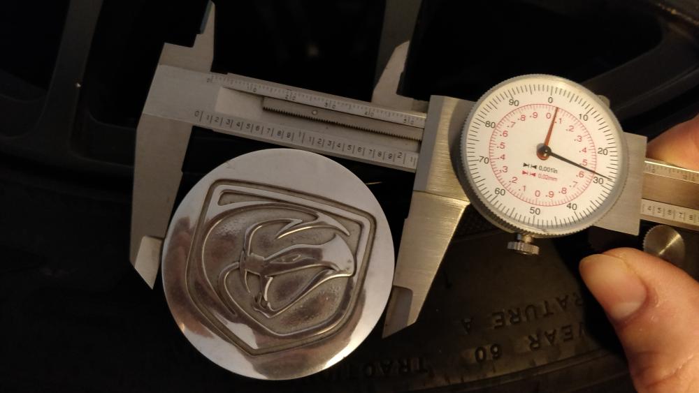

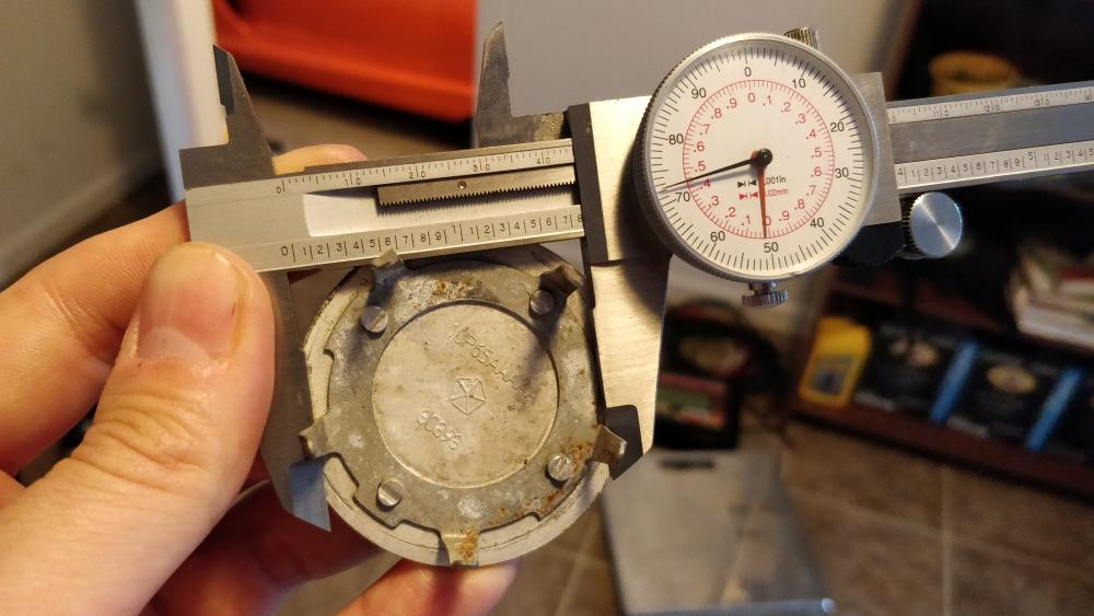

      Hi everyone – new here and new to Vipers. I have a 2002 Gen 2 GTS and I want to put Sidewinder II wheels on it. The car is factory height so I’m not worried about the fit. My question is around the center cap size. Will a Gen 2 Sneaky Pete center cap fit in the Sidewinder II center cap holes?
      Thanks in advance,
      Troy
      Hi Troy,
      While I do not have access to Gen 2 centercaps, here are a couple photos of SWII centercaps you can use for reference.
      The overall outside diameter is 2.128(ish) inches. This is the same size as the recess in the wheel.
      The centercaps clip in with metal spring tabs. The “as-clipped-in” diameter of this is 1.772(ish) inches.

      The Gen 2 cap will fit.
