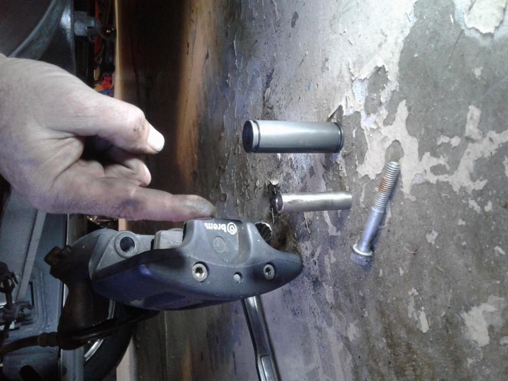

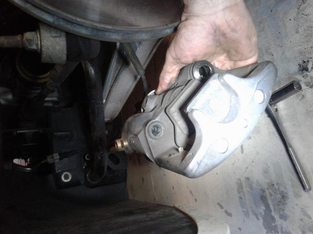

20171025_104854.jpg 20171025_104723.jpg Fixed the park brake problem, the factory did not lube the upper slide, see picks. Works perfect now and will wear even now.
