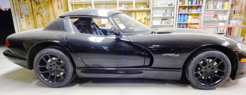

      Is your car lowered?
      Mine looks like it has plenty of room between the tires and the fender lip.2016-02-07-Black-Wheels-2.jpg

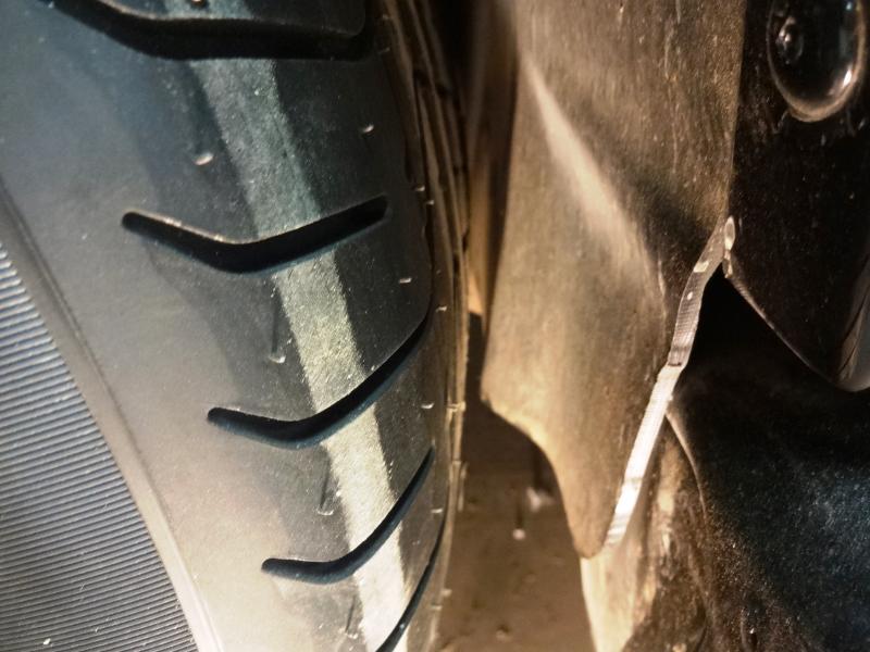

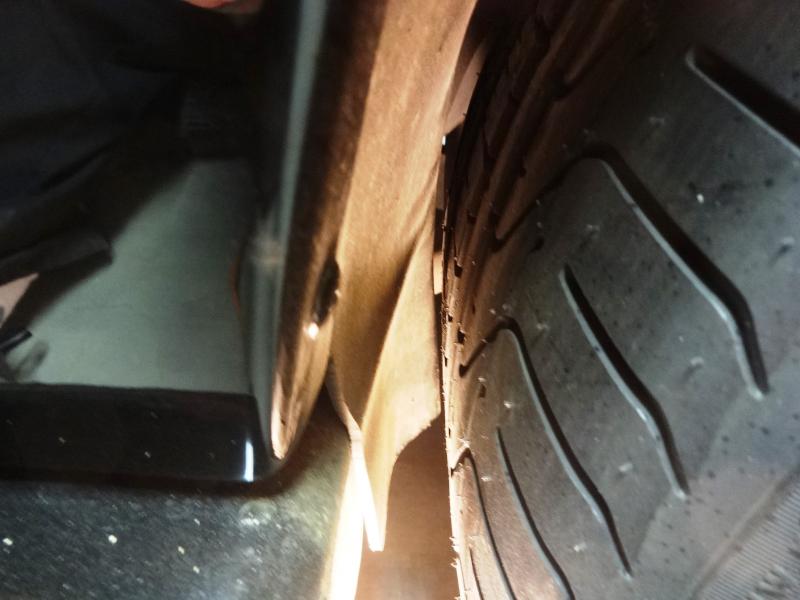

      2016-02-13-Clearance-1.jpg2016-02-13-Clearance-2.jpgI drove around for about a half hour this afternoon, even got on the highway, got home, parked in the garage, went into the house and two hours later remembered that I wanted to check the clearance.
      I was amazed to see that I now have more clearance than I had before.
      How did that happen?
      Did the tires shrink?

      Guessing the first set of photos were taken immediately after mounting the wheels and lowering the car without driving or rolling the car. That would mean the tires were binding against the ground and the suspension hadn’t completely settled yet.

      Guessing the first set of photos were taken immediately after mounting the wheels and lowering the car without driving or rolling the car. That would mean the tires were binding against the ground and the suspension hadn't completely settled yet.
      Makes sense.
      I’m happy with the results.

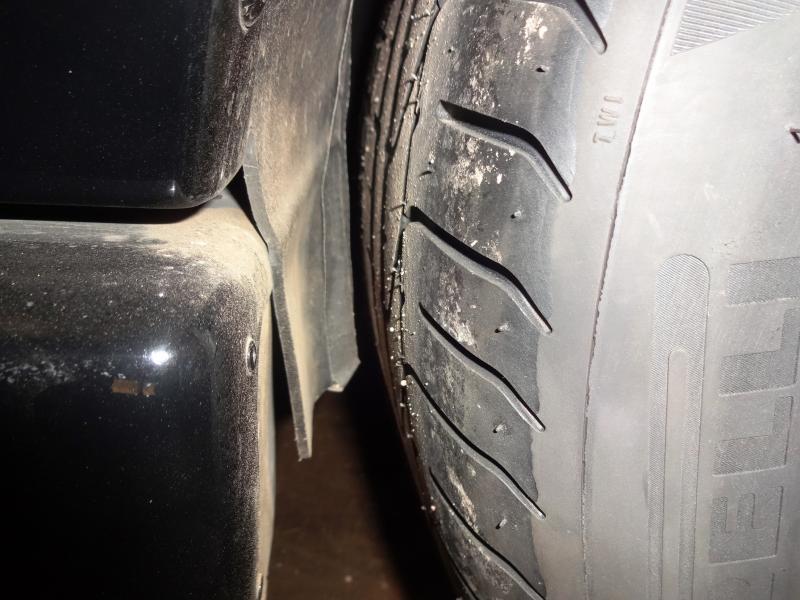

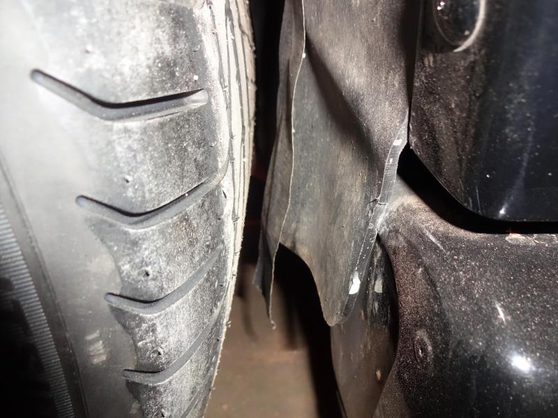

      I have a 1996 RT/10 wearing 2004 wheels (19″ on the rear, 18″ on the front) and Michelin Pilot Sports.
      I read about the Pirelli deal and the consensus seemed to be that the Pirellis would be fine even though slightly different in dimensions.
      Well, the new tires are mounted and the wheels back on the car and I’m concerned about the clearance between the rear tires and the front edge of the rear wheel wells.
      As you can see by the photos I have about 1/4″ on the right and barely 1/8″ on the left.
      Are the tires going to scrape every time the car bounces?
      Is there anything I can do to flatten out that section of the wheel well to get more clearance?
