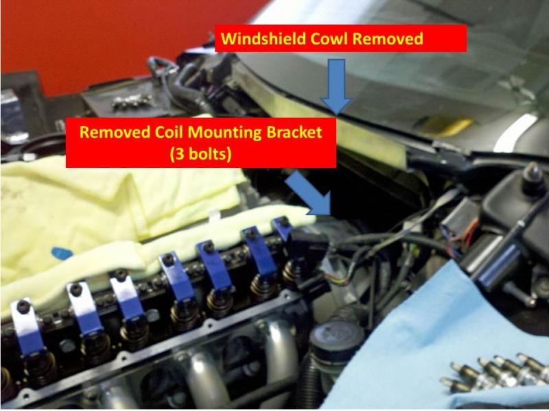

      Since I had to remove my intake (it’s off to Greg Good for some porting work), this made access to the coil packs much, much easier. However, removing the intake is not required. Removing the cowl is required and consists of unscrewing 4 screws.

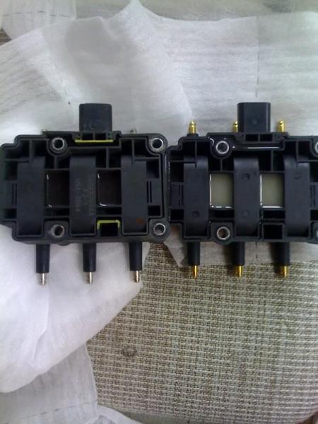

      I weighed both the OEM and SD coil packs and found there was little difference in weight:
      OEM Coil Packs: 5 lbs, 3oz
      S.D. Coil Packs: 5 lbs, 4 3/4oz

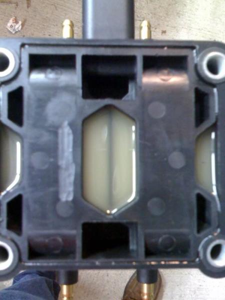

      I believe the difference in weight *may* due to the additional resin contained in the new SD coil packs. Here are some photos comparing the OEM to SD coil packs (OEM on left):

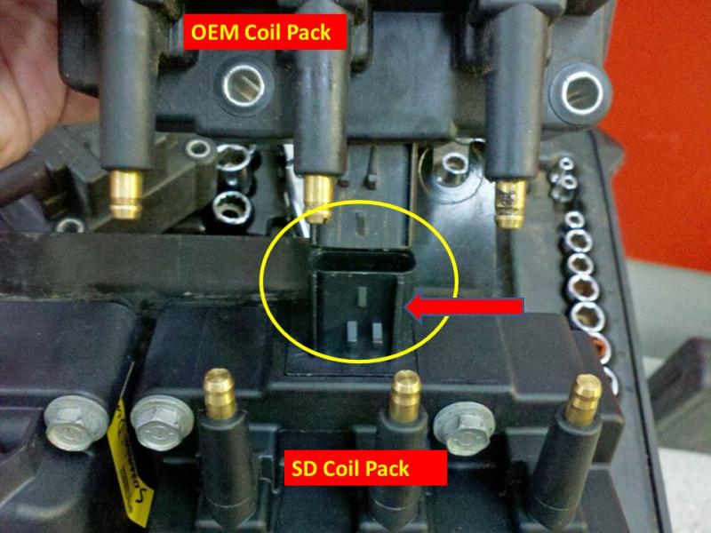

      Although the instructions stated no modifications are necessary, one modification is indeed necessary. One of the connectors on the new coil pack will not fit into the wiring harness connector. It appears that the new coil pack connector has a plastic guide offset which is preventing it from mating with the wiring harness connector:
      This will need to be ground down in order for it to fit properly. I suspect this design was made for the SRT Viper truck which may explain the incompatibility issue.

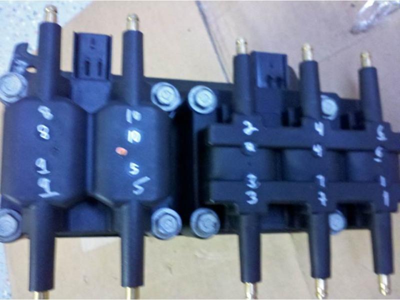

      As I noted earlier, the new coil packs are not stamped with the individual cylinder numers like OEM. I took my Sharpie and wrote down the cylinder numbers so I can easily see them from under the hood:
      I opted to remove the coil pack mounting bracket and install the coil packs outside of the engine bay. This is not necessary. The coil packs can be removed from behind the intake by simply removing the 8 bolts in the picture above. The bolts will back out and clear the cowl area.
