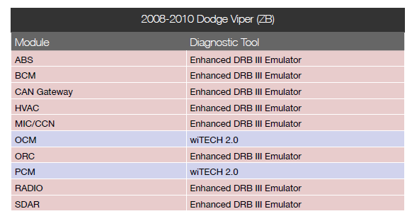

      brickauto said:
      The tpms are original Mopar parts, I was told that 2009 is the year chrsyler switched out of DRBIII and into some hybrid of old Mopar and CAN bus during the bankruptcy era.
      http://www.oemtools.com/homeproducts/chrysler.html
      I was told to try installing the old wheels (with original tpms) and see if the car will relearn.
      I may try to stop by discount tire to see if they can help program.
      CAS hasn’t updated their info about the Chrysler tools in awhile and are not as correct or accurate with their info as they could be, so take what they say with a grain of salt. Here is the correct information about the hybrid bus system which affects the 2008-2010 dodge viper. I have spent a great deal of time learning about these tools as I sell them in complete packages to shops.
      Chrysler has done a great job of making a mess of things and didn’t document it very well. As time passes they have done very little to clean things up as noted by the issues you’re running into with the various dealers not knowing what is what or not having the required equipment. There is also a lot of inaccurate information around the web steering people wrong when it comes to the various factory scan tools so be careful where you source your information from. Very very few people will have spent as much time as I have with these tools (could be counted on one hand) and even I have gaps in my knowledge. You will usually need multiple sources to make sense of something.
      As for the TPMS, Viper Specialty definitly sounds like he knows his stuff so I would listen to him.
